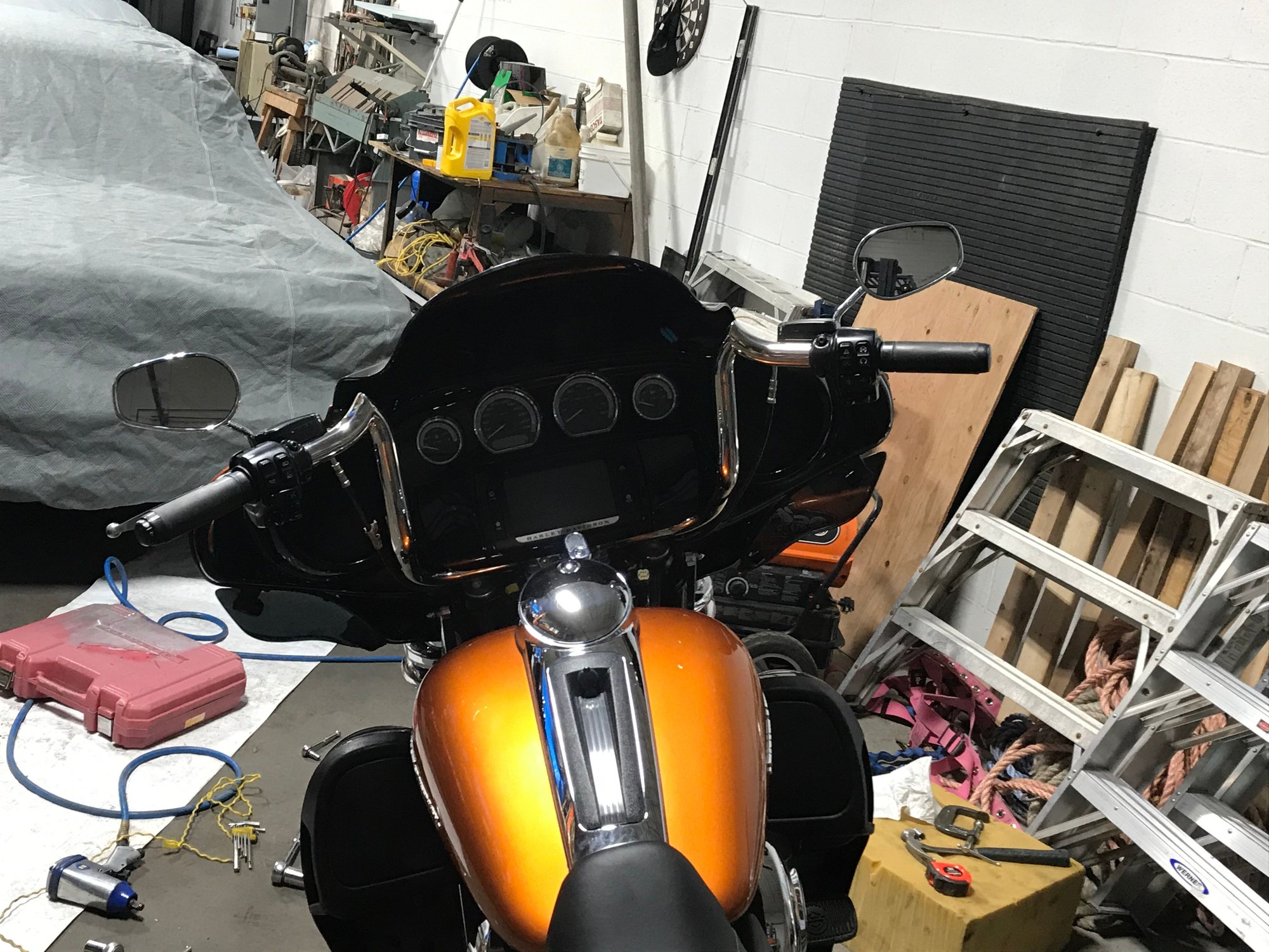

I am 5'10 and put 14inch Burleigh Highball Bars on my Road Glide (http://www.burleighbars.com.au/harle...andlebars.html) . No need to extend the cables for 14inch bars (generally only). It has made riding much more comfortable.
I could of gone 16inch bars but it would of made U-turns a little harder to perform but still do-able. It all comes down to your arm length and body proportions. I have long arms while some people at the same height as me have short arms.
Hope it helps.
