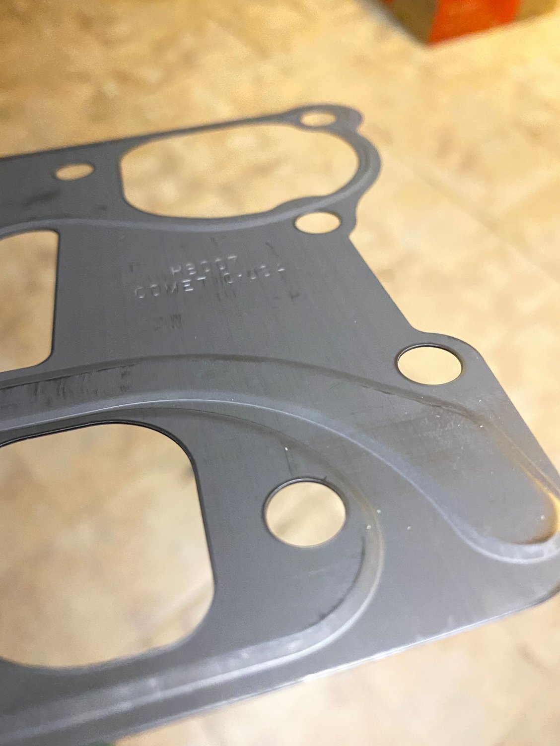

Dumb, or maybe not...question, but the raised portion of the lower rocker box gasket goes up on top of the cylinder head correct?
This way up toward the sky right? It wouldn’t make sense to have the raised portion flipped over in the breather area/vent right?? I’m second guessing my instincts since these came with no directions...

I could be wrong, but I don’t believe it matters.

Check with Cometic to confirm but my understanding is the name /part# faces up. So the way you show it is correct.
