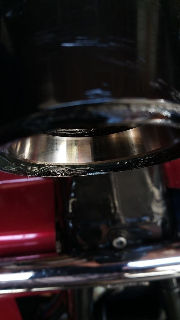

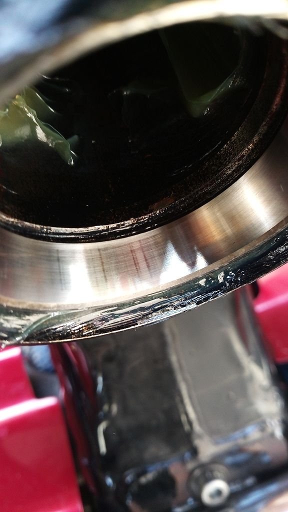

today I start to remove the old neck stem bearing at my 1995 FLHTC.
Bearings are changed, tomorrow I reassamble all.
I could see good the marks from the rolers.
The movement left to right was smooth but a little to easy.
First I thing about just to adjust but after removing the bearing I check the surface at the races and decide to change.
To remuve the old races I use a Ř 22 mm Steel rod, and huge hammer.
It was a little tricky but it works cause there is to less surface where the rod conect.
To remove the lower bearing, I use the traditional way, cut of the cage and than cutting off the inner race with a hispeed dremel and 1" cutting blade.

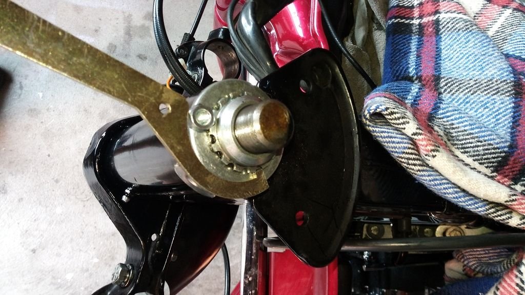

To tighten the bearing adjuster I havn't the right key so I improvise with a 1/2" nut and the PS shock key.
I tight the bearing adjuster that it moves smoth but not to easy.
The Harley mechanic told me i should tight first a little harder that it runs smooth cause the bearings will set down a little.
