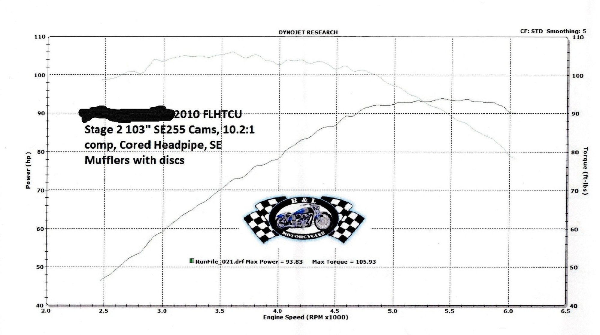

Just for interest on this thread here is what my 2010 FLHTCU is: was a 103 HD stage 2 with SE255 cams, SE air cleaner and SE fatshot mufflers. Crank failed so engine all rebuilt. Now bored one size over, heads ported, bronze guides, same SE255 cam, same SE air cleaner intake, cat removed, same fat shot mufflers, compression 10.2:1, crank is balanced and welded. Had a SE tuner (from the stage 2 build) and shop used that with a dyno tune. Bike runs much better, rarely has a decel pop, seems to run very well. Power is adequate.
