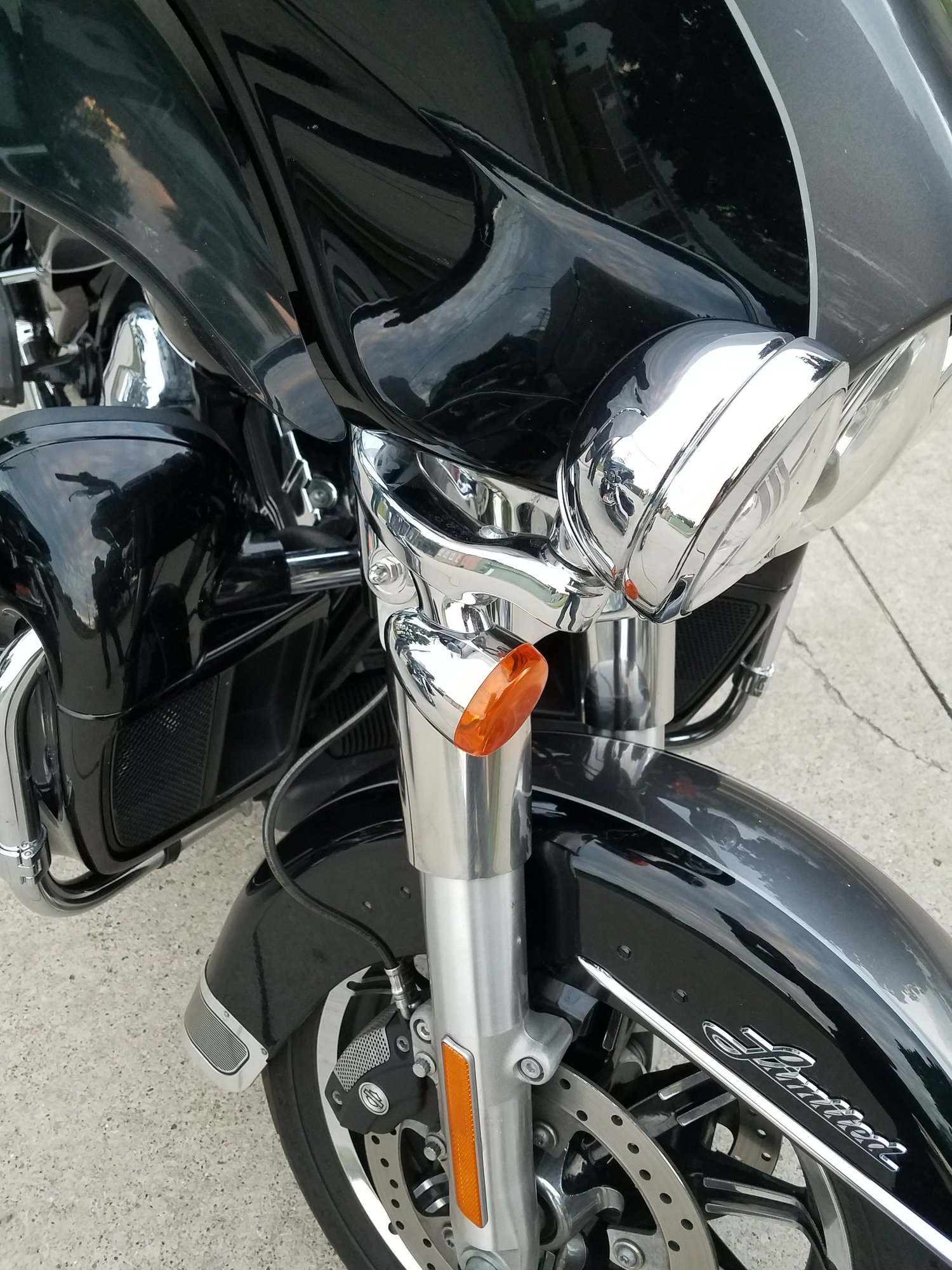

I want to upgrage my front turn signal flat lens/bar on my 2008 Ultra to the newer style bullet turn signals. I've looked and looked for a part number without any luck. Anyone have the number I'm looking for. I pictured a friends limited bike for the style I'm looking for.

You can upgrade just the turn signals if you want and keep everything else the same. The replacement turns are:
69147-03 with clear lens
69153-03 with smoke lens
69063-03 with amber lens
The bulbs are all amber and can be upgraded to LED with Custom Dynamics LED bulb inserts.
The complete kit to upgrade to your friends bike is 69227-04A. The bullet turns are sold separately.
