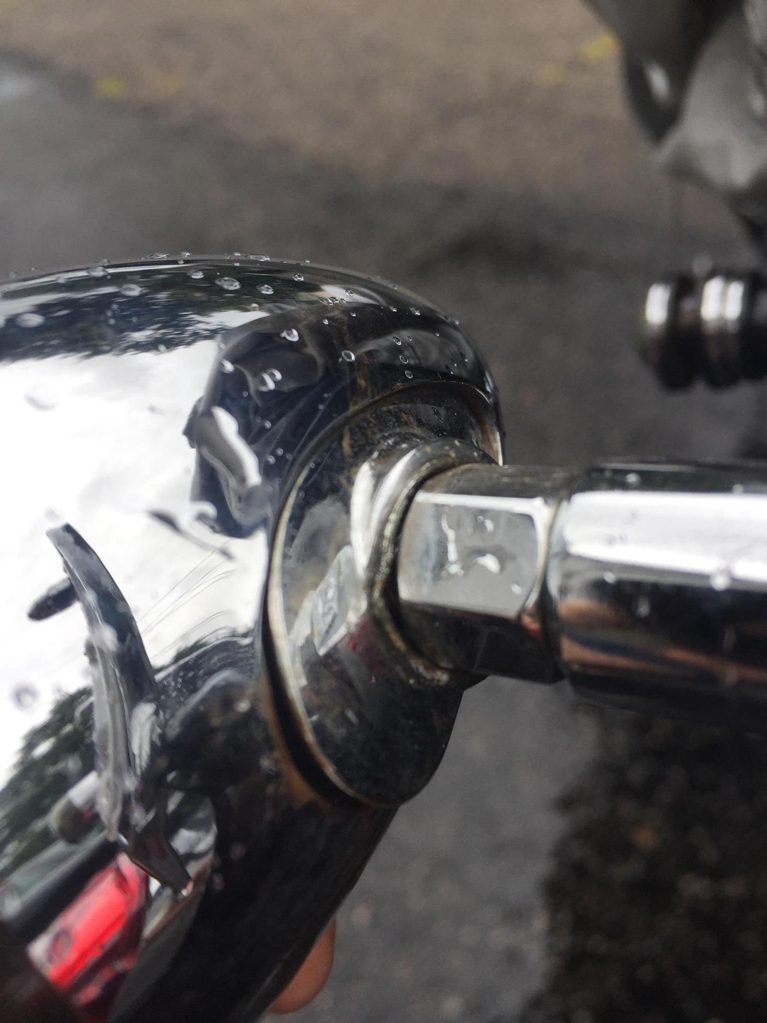

Hi, I have a 2007 Dyna FXD. I noticed this morning the bracket that sits in the left rear turn signal is cracked, causing the turn signal to become loose. It is a bullet style turn signal, and the bracket sits flush in the turn signal, not an arm or long bracket like the OEM part.
Hope the picture can describe it, anybody know what it could be called or what it is?

Your pics don't help at all. These turn signals have the lens, housing & mount arm/bracket. Which one of yours is cracked? Guessing this pic isn't from your bike...if not, take one & upload.

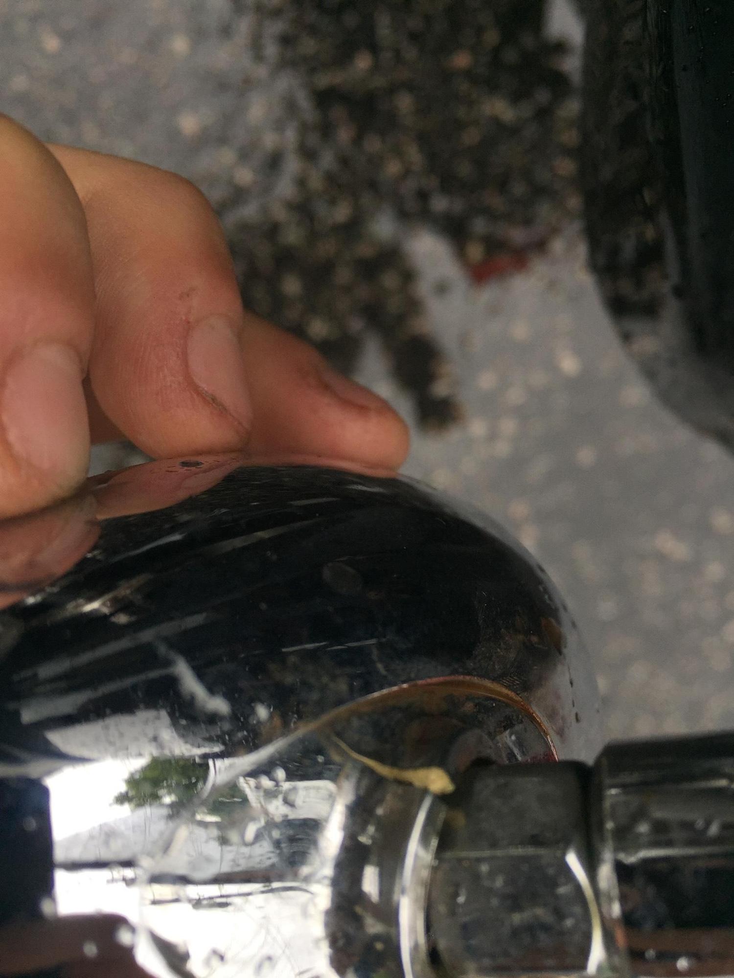

There we go, it's the part that is cracked:

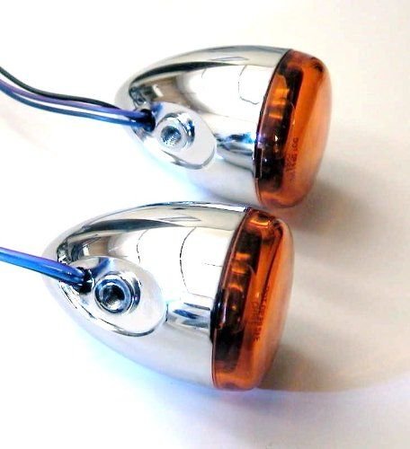

https://www.maranellomotosport.com/d...uctid=21608363

That's an aftermarket cover or "beauty ring",, it's not part of the factory signal. If your signal is indeed loose then it's the signal housing that fractured also.
Ranger 73 offered the link that shows the part,, scroll the photo's of the relocation kit in the link and you'll see the part.
Sadly you have to buy the entire signal,, not just the housing. You can many times find them on Ebay or the classifieds here for reasonable cost.
Just be sure to get a front signal,, the front is a dual element bulb with three wires,, the rear is a single element with two wires,, left side/right side are interchangeable but not front/rear.
