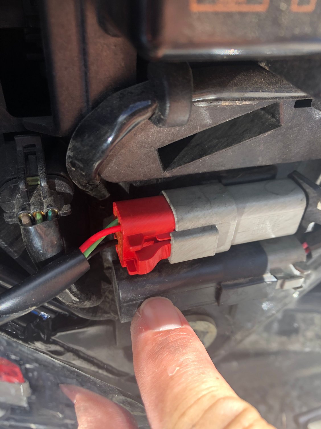

Another question, just curious. Again thanks Vernal for the Diagnostic book. What is the other "data" port that's under the data port that I have the FP3 connected to?

Originally Posted by HarleyorNuttn
You guys have been awesome! This is the second time I've used this Forum and its been very beneficial both times. I cleared the code and it hasn't came back on...YET. Crossing fingers. I have a new map on the bike, running better, but not perfect. I have go to a campground every weekend which is about 45-60 minutes away, so I think I'll run the Autotune and hopefully that makes everything right. I just want to make it to Sturgis and back!
How about bout a picture and location, number of wires and color.The Data link connector is under the left side cover? I was thinking the accessory connector but I believe it’s under the seat.

Are there wires going to it or is the black part just a cover? What color wires go to the gray end?

It looks just like the data port, but there is a module plugged into it.

That plug is for your ABS brakes, the module that is plugged in is a Diode Pack.
