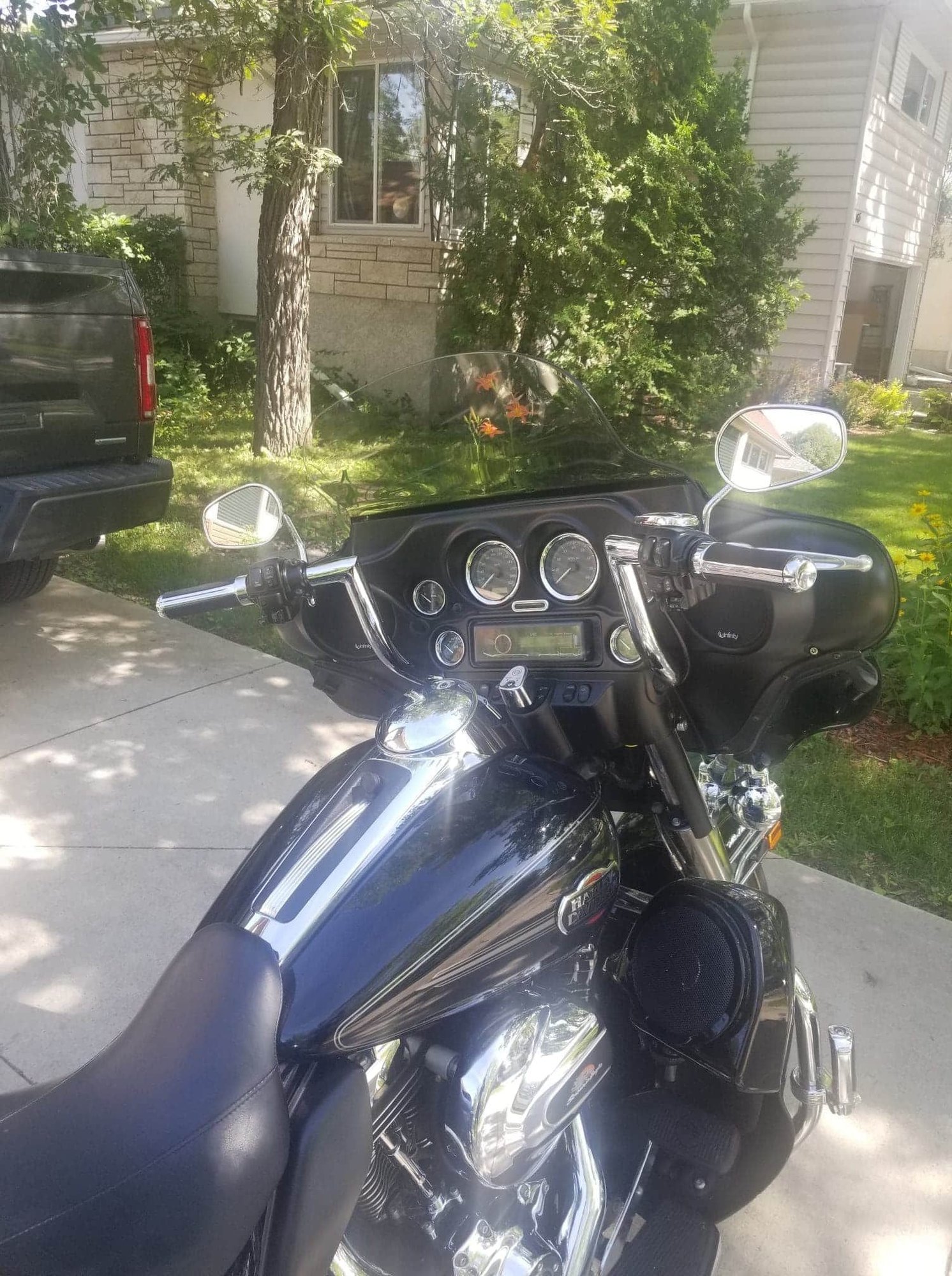

These are 10” LA Choppers twin peaks on a 2010
Had to extend electrical only . Brake line, throttle by wire and clutch were fine. Just had to reroute the clutch cable a little.
There is a green plug/connection on the throttle by wire. Eliminate it. It will be no end of grief! Some cut it and solder the wires. I broke open the plug ends and removed the wires. That way I had both the female and male wire ends and just replugged them and heat shrinked each.
I used nylon cable sleeving on all. 1/2” on electrical and 1/4” on TBW. Makes pulling wires through bars much easier. I used Thin steel cable to pull wires. Lots of good videos on this...KST customs, ride it wrench it, etc

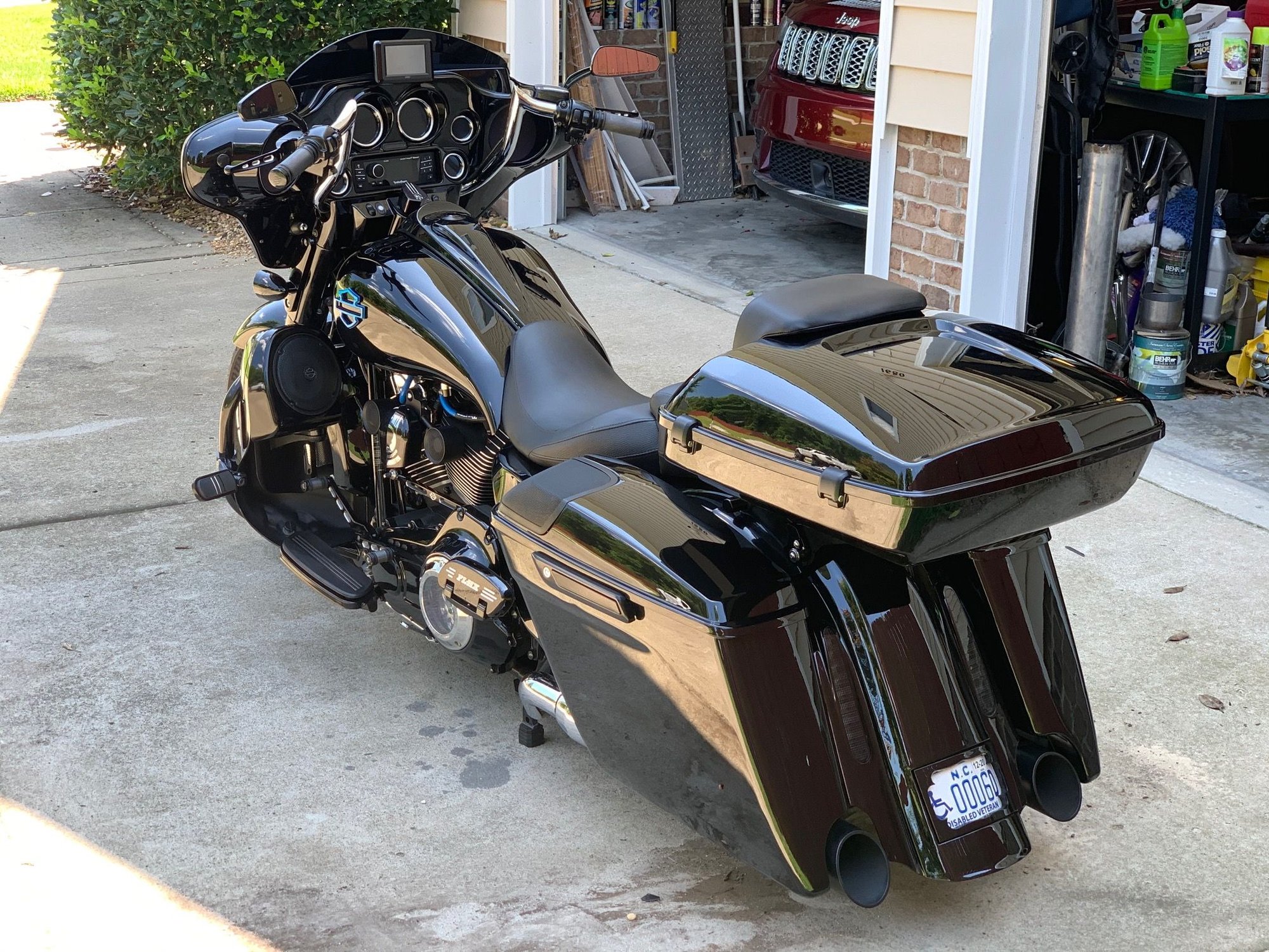

16" LA Choppers Twin Peaks............
Your comment; "they would be for looks only", sounds like you are simply a poser wanting to look cool.
If that's the case, buy the cheapest set out there and bolt'em on..........and look cool setting in your driveway.
