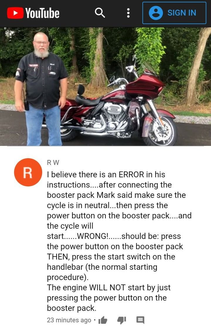

I asked the question, in the first place, because I watched the video that is linked in a previous replay and the HD tech SPECIFICALLY said that once the battery pack is connected MAKE SURE THE CYCLE IS IN NEUTRAL......PRESS THE BUTTON ON THE BOOSTER PACK....and the cycle will start. He makes no mention of starting the cycle using the handlebar switches.
I didn’t watch the video, but if the guy said that he should have all his tools taken away.
Here's one of the comments from the video.
