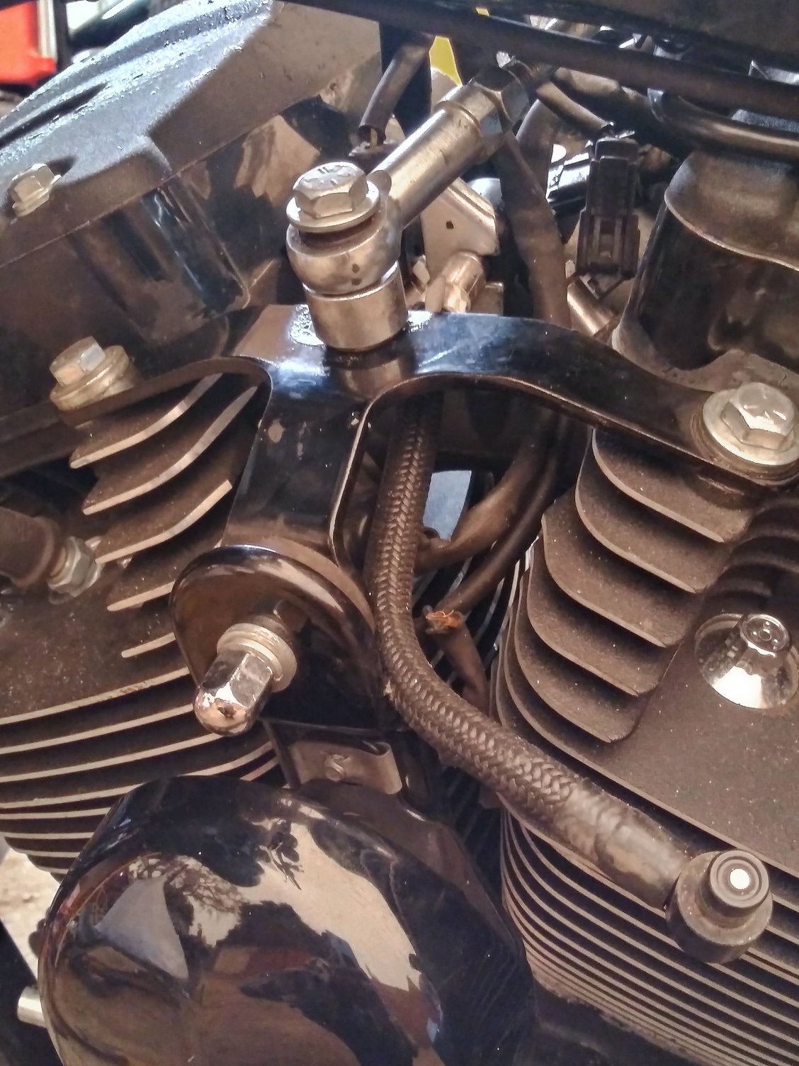

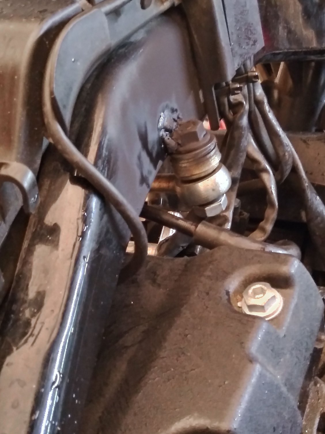

Default Top engine mount
Top engine mount was threaded in old head. I didn't want to drill into new head so I just welded a nut to the frame and tapped and welded a nut onto the head bracket and not the prettiest weld but it works. Took her out yesterday with no mount and could start to feel that famous death wobble. Welded the Top mount up and problem solved. Once again thanks.
Old Sep 9, 2020 | 08:28 PM
handirifle's Avatar
handirifle
Joined: Sep 2018
Posts: 6,086
Likes: 1,840
From: Kalifornia
Check that weld often, it doesn't look too strong to me. Might crack when you least expect it, and if it causes the wobble it could suddenly make life exciting. If your skills are not up to it, find a buddy whos is, and have him do it. Small pride to pay for a safer ride.
