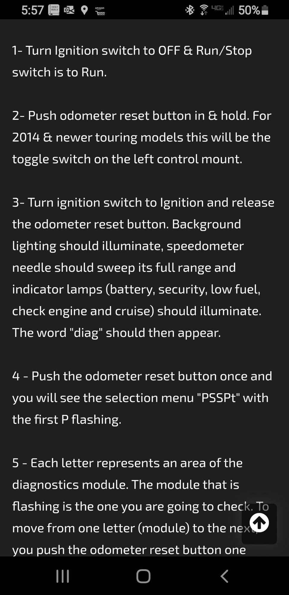

Searched out check Engine light in the search bar. Went to page 4 before anything about engine light came up but I found a thread that was from fuelmotousa.com and it had instructions on how to check the trouble. So I followed the directions
Followed until step 4 when they say "PSSPt" will start flashing. Well that didn't come up on mine.

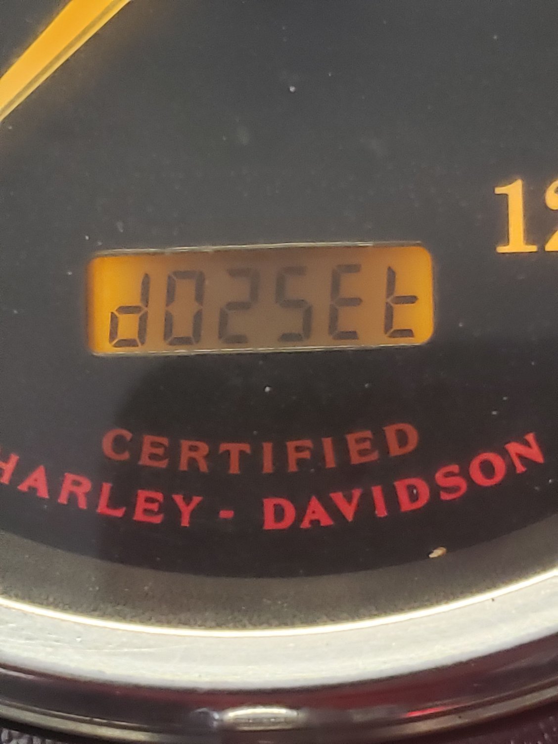

Well didn't see that in the instructions so I just pushed the speedo button again and this showed up.

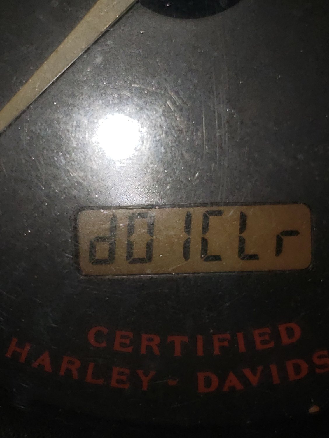

Don't know what that is but it is different than the first and all the others to d10clr.
Any ideas on if this has a meaning or am I not doing something right?

If I'm not mistaken , you should be using Method 2 on 2000 - 03 bikes , give it try and report back .
https://www.hdforums.com/how-tos/a/h...e-codes-413169

Rear ignition coil primary voltage out of range.
