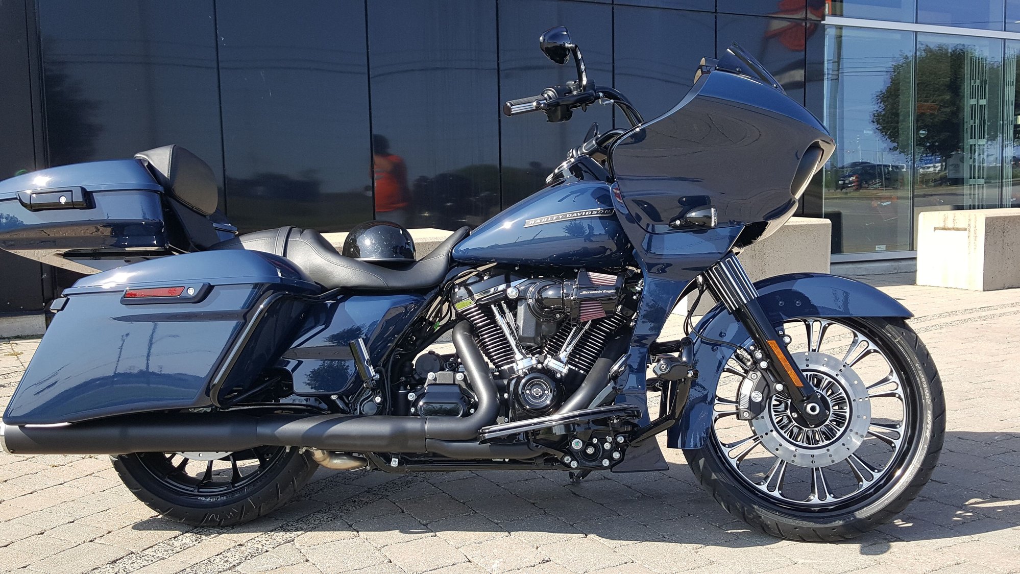

just picked up a new Road Glide Special last year (2019). Added quite a few parts to it but nothing major by any means other than swapping out the front 19" for a 21. Been experiencing a high pitch whistle that seems to be coming from somewhere in the fairing at higher speeds, and its driving me nuts. Now, I've taken her into Harley on a number of occasions to rectify this sound but they can't fix it and gave me some bullshit answer the last time at Mackie. Any suggestions on what it may be or does anyone know someone close to Toronto or surroundings that's an expert with this ****?

Are the speakers stock or were they changed out? Speaker pods might need sealing especially if they were modified with other speakers.

Bike looks great good job. I had this and the whistle was coming from the lower edge of the wind shield where it meets the fairing. Try removing the shield and putting some thin foam in the between shield and fairing

They're stock dude.
Same here on the location where it was whistling. Front edge/seam of the windshield. Easy enough to use some electrical tape over the seam to verify.

I had this with an aftermarket windshield. Replaced it with a new Clearview GT Recurve and no more whistling.

Windshield 99/100 times.
