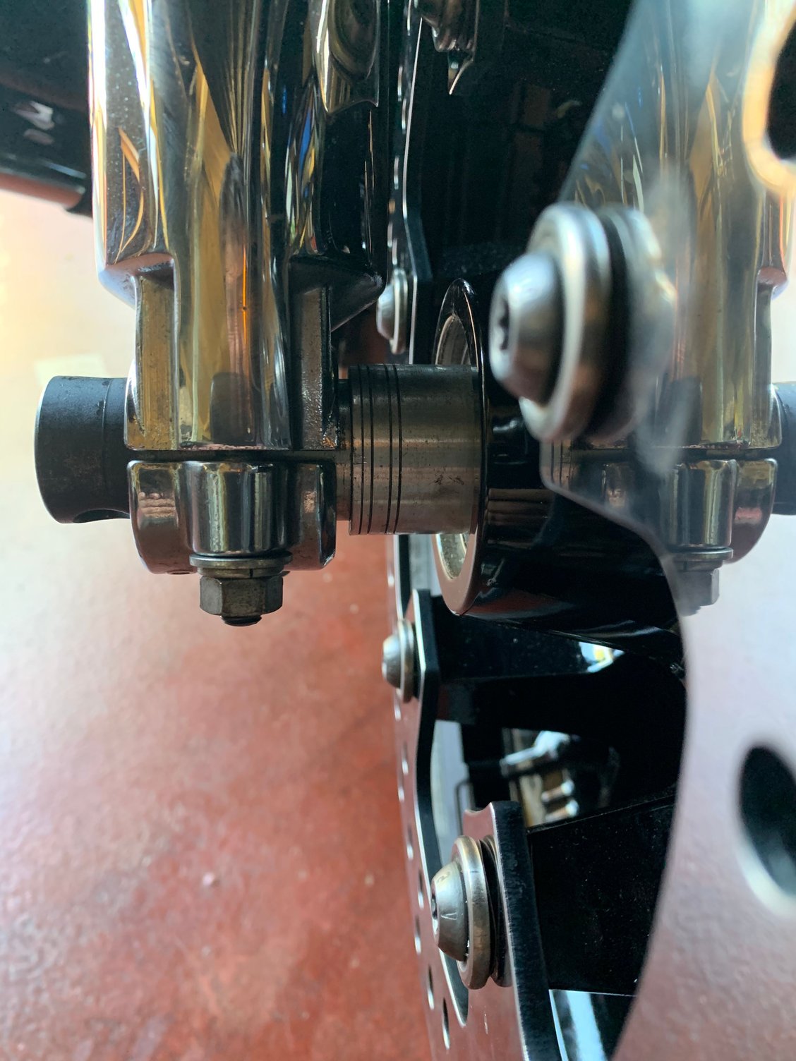

3. I then noticed a gap between the spacer and fork leg that wasn’t there when I had the stock wheel on. I installed the stock wheel again just to be sure. Pic is below. I’ve read that this shouldn’t be an issue and is more or less a common thing. The wheel sits solidly without any play.

Is the gap at the spacer ok? I can pull it in by seating the spacer against the leg and tightening the clamp side before the axle side. I also read that is the wrong technique. Conversely I can also try to pull the clamp side leg a little to center the caliper on the rotor. It doesn’t seem right to have to suck in or pull out the fork legs to install this properly.

If you have a warped rotor, depending on how bad, you would only feel it when the brake is applied. But, as you stated, it is warped enough that it is slowing down the wheel when it rotates then I would start there. As for the gap with the spacer, there shouldn't be any gaps, that's what the spacer is for it should rest up next to the step on the axle. As long as the hub on the new wheel is the same width as the hub on the wheel you took off, everything should fit up tight. If the hubs are the same, then I would leave the lower fork clamp loose then snug up the axle to pull everything together, than snug up the lower fork clamp, then torque the axle bolt and then the lower clamp. Then check to make sure the caliper is centered on the rotor, of course you will need straight true rotors to do this.

Been running 19" enforcer on a 2011 RKC with abs for 5 years. Fits perfect using 2011 spacers. Double check, triple check.., to make sure they installed the correct bearing. The abs bearing is wider and could explain the gap you mentioned.
The ABS bearing is on the left side and different color from the regular bearing. I think that one is correct. It’s the right side that has me concerned. The stock wheel looks like the bearing is sticking out a little bit vs flush with the Enforcer one. I will be checking again tonight.
