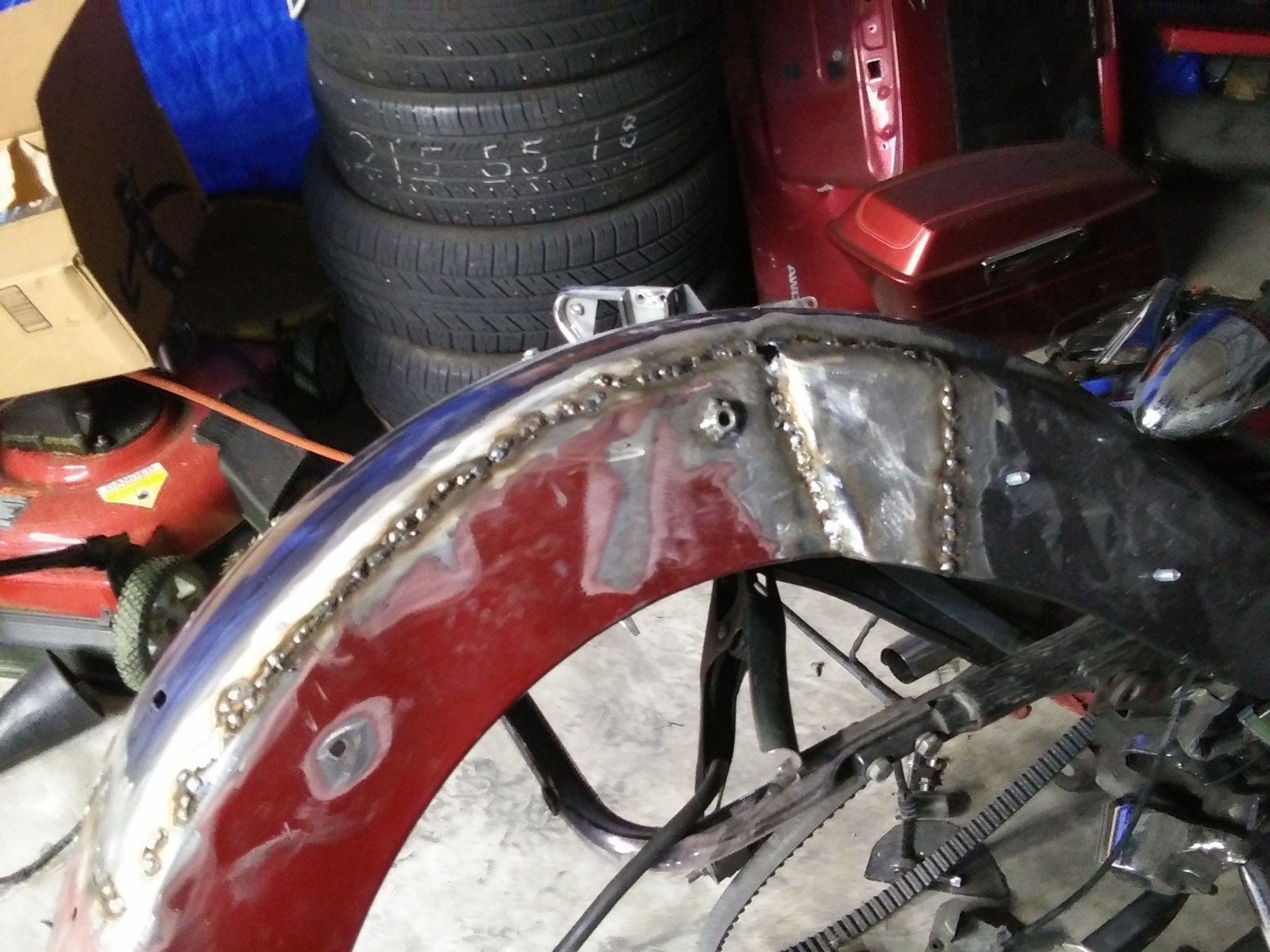

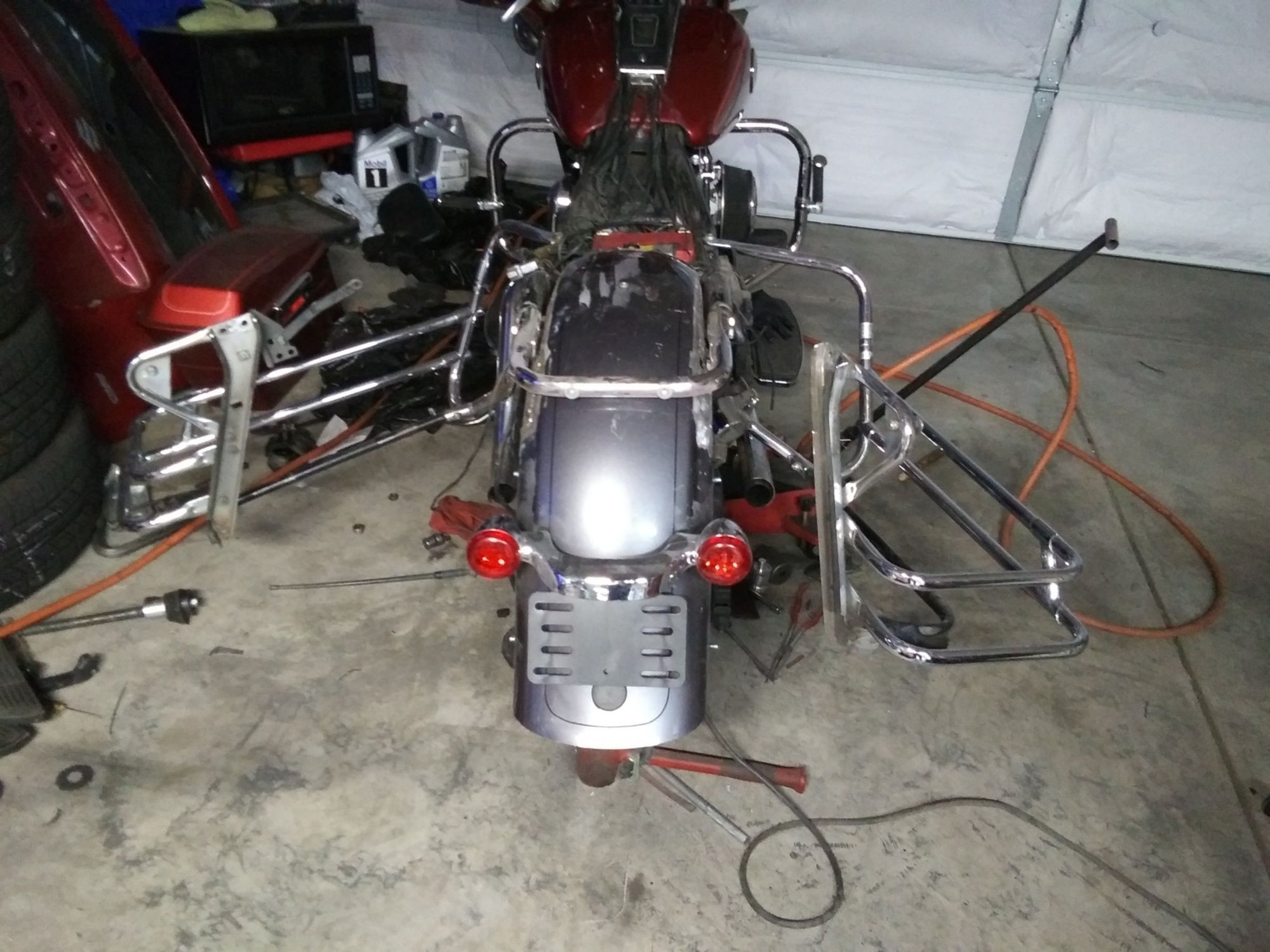

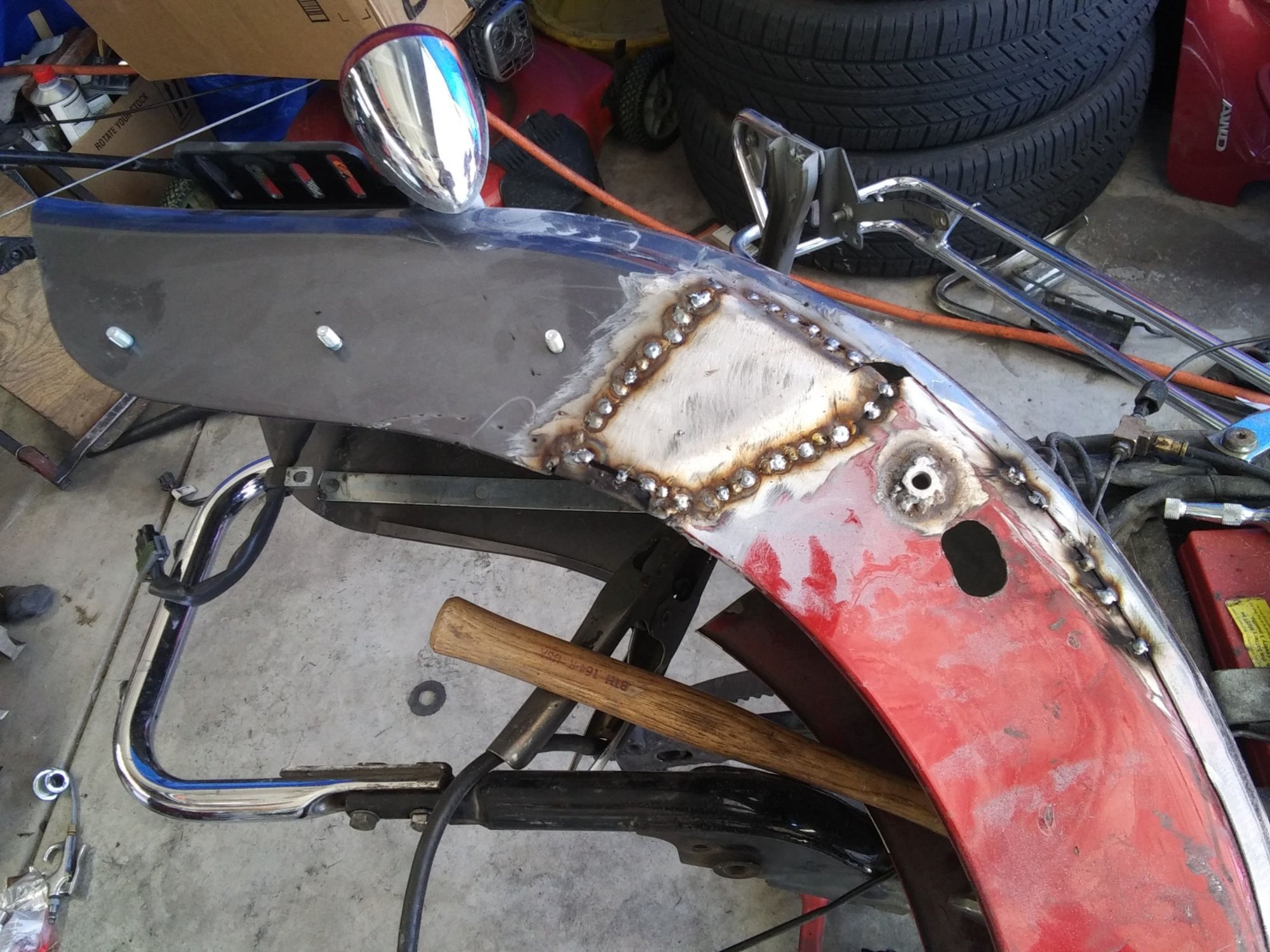

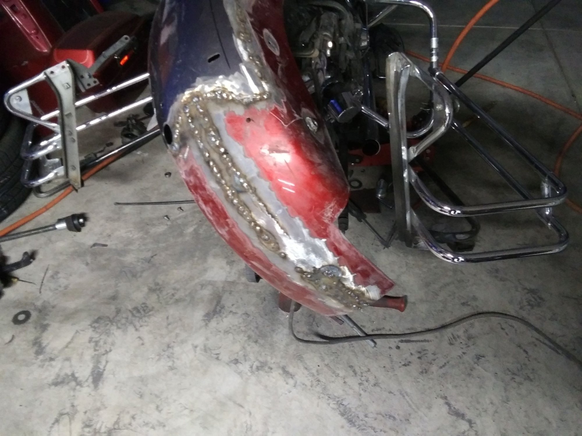

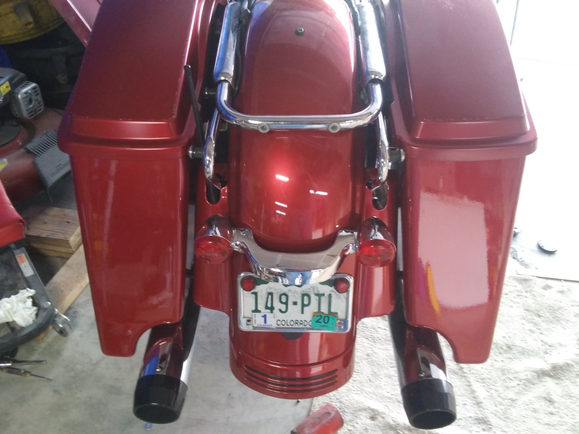

I put a 2014 rear SG fender & 2012 tires & wheels on my 1999 Ultra.
Old Nov 8, 2020 | 02:33 PM
twistedcherokee's Avatar
twistedcherokee
Joined: Oct 2006
Posts: 1,350
Likes: 46
The bags are aftermarket but the lids are 2012.
