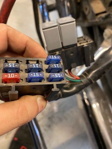

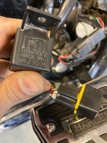

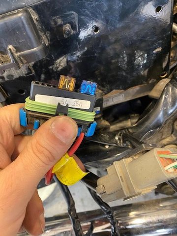

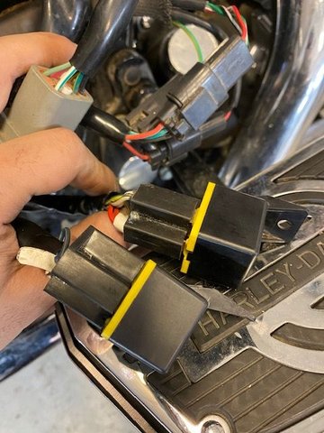

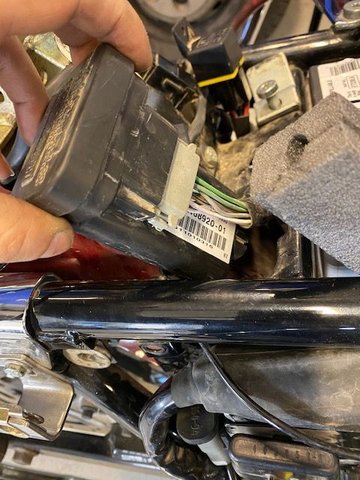

sorry the late answer guys have been down with some sickness but are good again i have taken a movie but i can upload it ?? her is some differne pictures. after i have stripped the hole bike and the taking of connections and put them toghether suddently it dont blink 3 times anymore when i set it to on maybe i burn something of since it aint doing it anymore or maybe it help taking some of the connecters of and on again also fuelpump connector of an on again.
Status is it not blinking anymore but still no spark on the plug
. ....HELP

I believe in photo #2 you're holding the security system. This is what they look like.....

Originally Posted by brakeless
i believe in photo #2 you're holding the security system. This is what they look like.............
Thats right and my tought is that maybe after i have taked the connector in and out and hit the box gently some times maybe its why it have stopt making those blinks when i turn the ignition to on????

Looks like you have a lot going on. What are you jumping the battery from? Do not use a running vehicle. If you have a security system and no fob I believe it may be preventing starting.
I'm hoping someone else will chime in and let us know if it will operate if you just unplugged the security system.

yes its because i havetthe hole bike stripped and i wanted to make the movie no iam jumping from a other battery so iam sure that it get enough power because i read if it dont get enought voltage i cant remember but shome thing will shut off so it dont make spark.
yes i unplugged and plugged in the the security box and hit it gently and now it not blinking anymore i hope thats why
do you think that if the fuel pump is broken it will make so the bike dont make a spark??

Do your turn signals work? If not it's because your security system has everything shut down.
