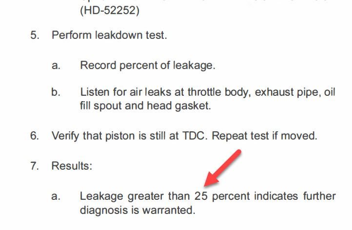

True. The service manual on late model bikes say up to 25% is OK.
Damn, that's a lot! I seem to recall seeing between 5 and 10 percent on my Evo.
Yep. I have a screen shot of the 2018 service manual somewhere. If I'm lyin' I'm dyin'!
Edit - found it in the 2020 service manual:
That's crazy.....
In my 2001 & 2003 Service Manuals it calls for a max of 10%....
