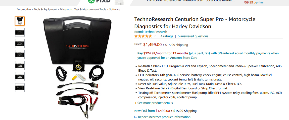

GearheadMike's Avatar
GearheadMike
Joined: Jan 2020
Posts: 934
Likes: 1,050
From: So Calif
I just posted this in another thread. The TechnoResearch VCM-TR4 (circled) for $400 is the same hardware as the $1500 one, but you have to buy a 'per bike' license, which is $35, unless you want a tuner license, which is more.
Thanks! Looks good. I'll check it out!
