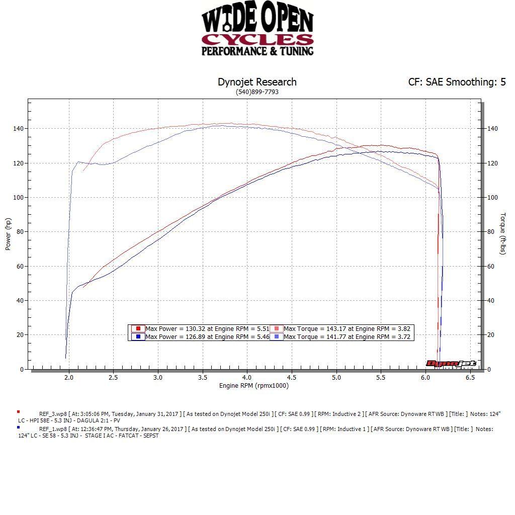

If you can feel it that is one thing, but if you are going just by the dyno sheet, be careful. Here is my Dyno sheet of my 124" with a Dragula 2-1 vs another 124" same setup except he had a D&D Fat Cat. Now I know these are 124" and I think that is pushing the limits on the Fat Cat, but notice the dip on the Fat Cat versus the Dragula pipe. My point isn't to say the Dragula pipe should be your choice, point is the guy with the Fat Cat was real happy with the performance, I talked to him for some time. The guy that did both installs wanted to compare the 2 pipes for his knowledge. So you may still have a small dip even with the Fat Cat.
