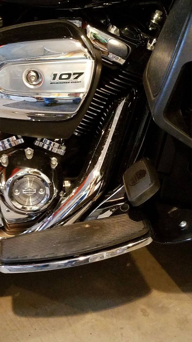

Here's a photo of the Kuryakn brake pedal on my ultra limited. I'm only 5'10" and found this more comfortable.
