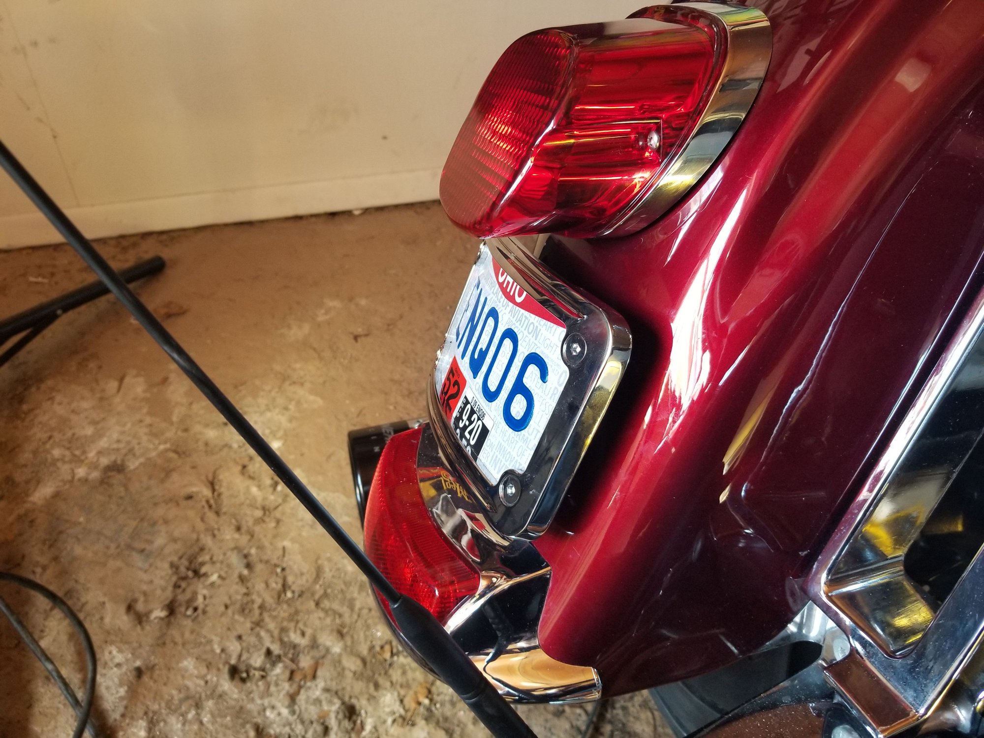

I also drilled holes and used https://www.denniskirk.com/v-twin-ma...iABEgJeYPD_BwE.
with a small plastic spacer to achieve the angle I wanted.
I used the reversed tail light lens for the light.
I really like the look of that but have a couple questions... When you drilled the holes through your fender, how did you protect the exposed metal after drilling the hole? Some type of clear coat or...? Also, which reverse tail light lens did you get, if you don't mind?

I used https://www.denniskirk.com/drag-spec...prd/215495.sku

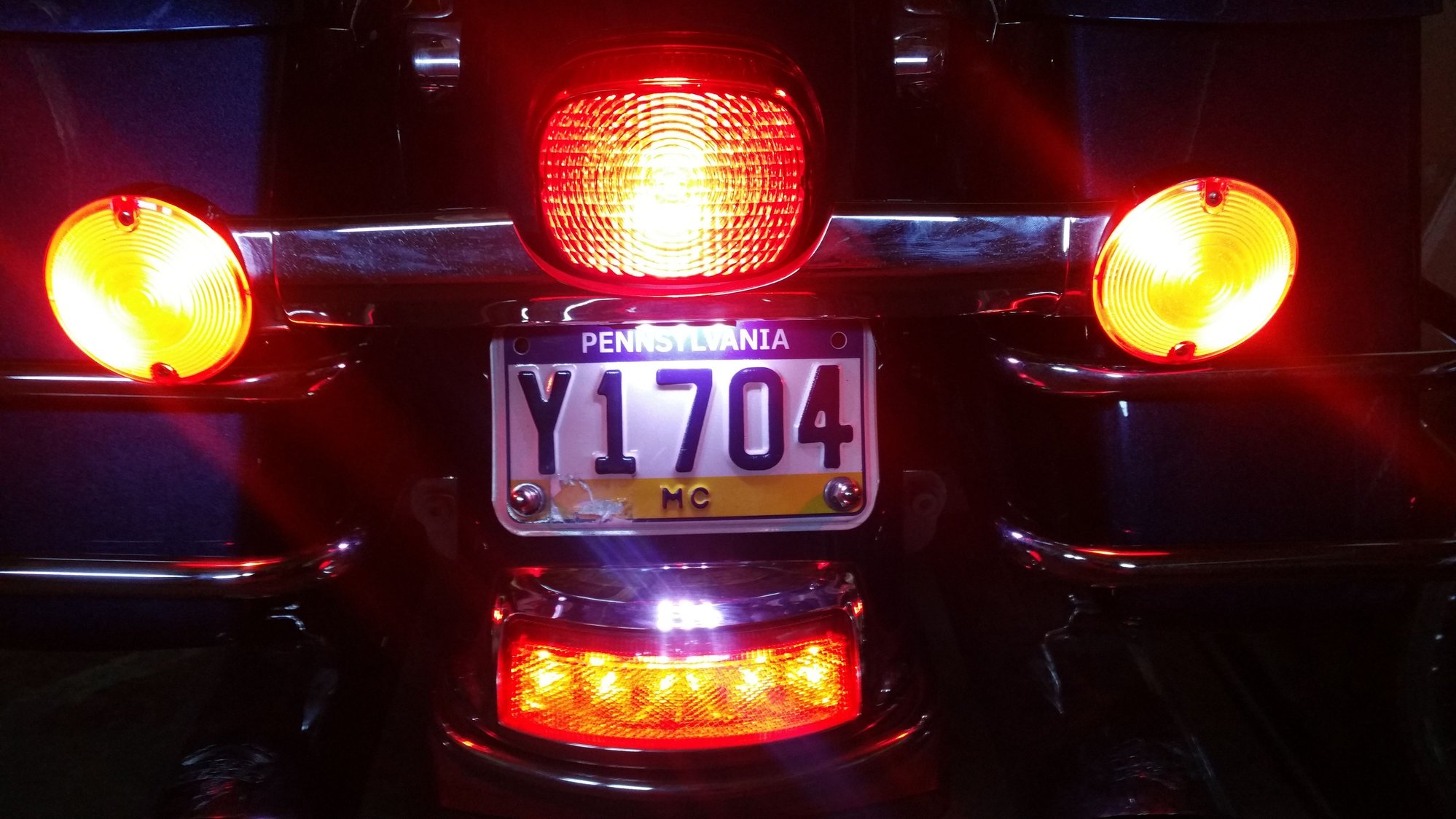

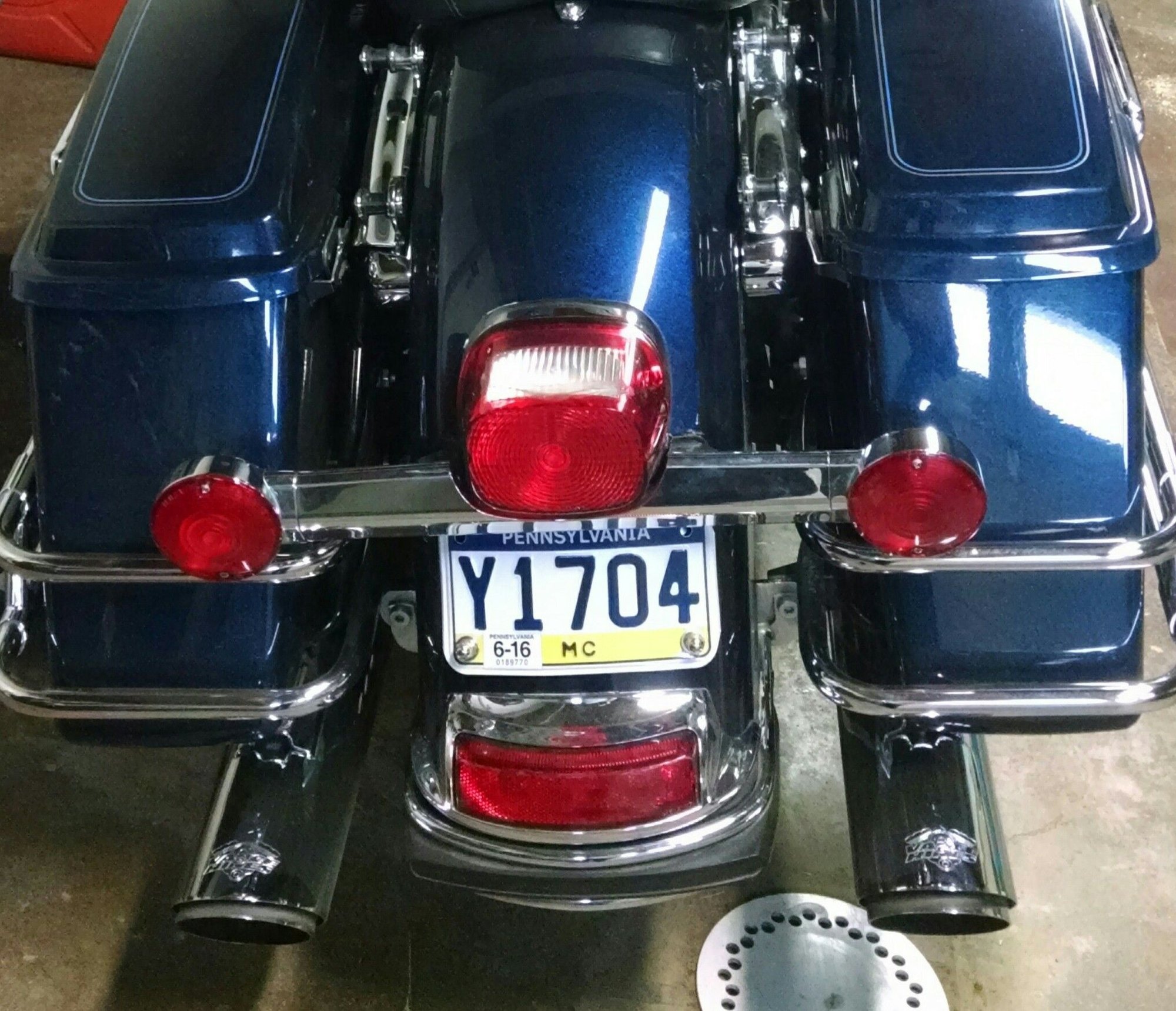

Sounds like you have the Street Glide bullet turn signals? If so, you could get the Street Glide plate bracket, as it attaches to the turn signal bar.
There should be a place to add a license plate light in the turn signal bar too, or you could swap tail lamps to get the the bottom-side clear lens.
All this assumes you will clear the fender tip light, but I'm betting you'll have clearance as the Street Glide plate bracket would tuck the plate up a little higher.
Let me know if you want a parts diagram and part numbers and I can post that info too.
I'm running bullet rear turn signals - part number 68615-04. So, you're saying there's a direct fitment for a license plate to that bar? That would really be something, I think. If you know the part number, I'd love to check it out.
This is exactly what I did with my previous 2012 UC. Got the SG bullet style rear turn signal used here in the classified. It had the tag light built into it. I then added the HD curved licence plate frame...used here as well.
I think it was this one...https://www.harley-davidson.com/us/e...ame/p/67900008
I was even able to tie the tag light from the turn signal bar into the wiring for the fender tip light. It was a bit of a chore but was able to do it. Next, I found a used solid tail light lens to finish it off.
You could also go with the lighted curved frame if you'd like...https://www.harley-davidson.com/us/e...ing/p/67900275
Good Luck!
