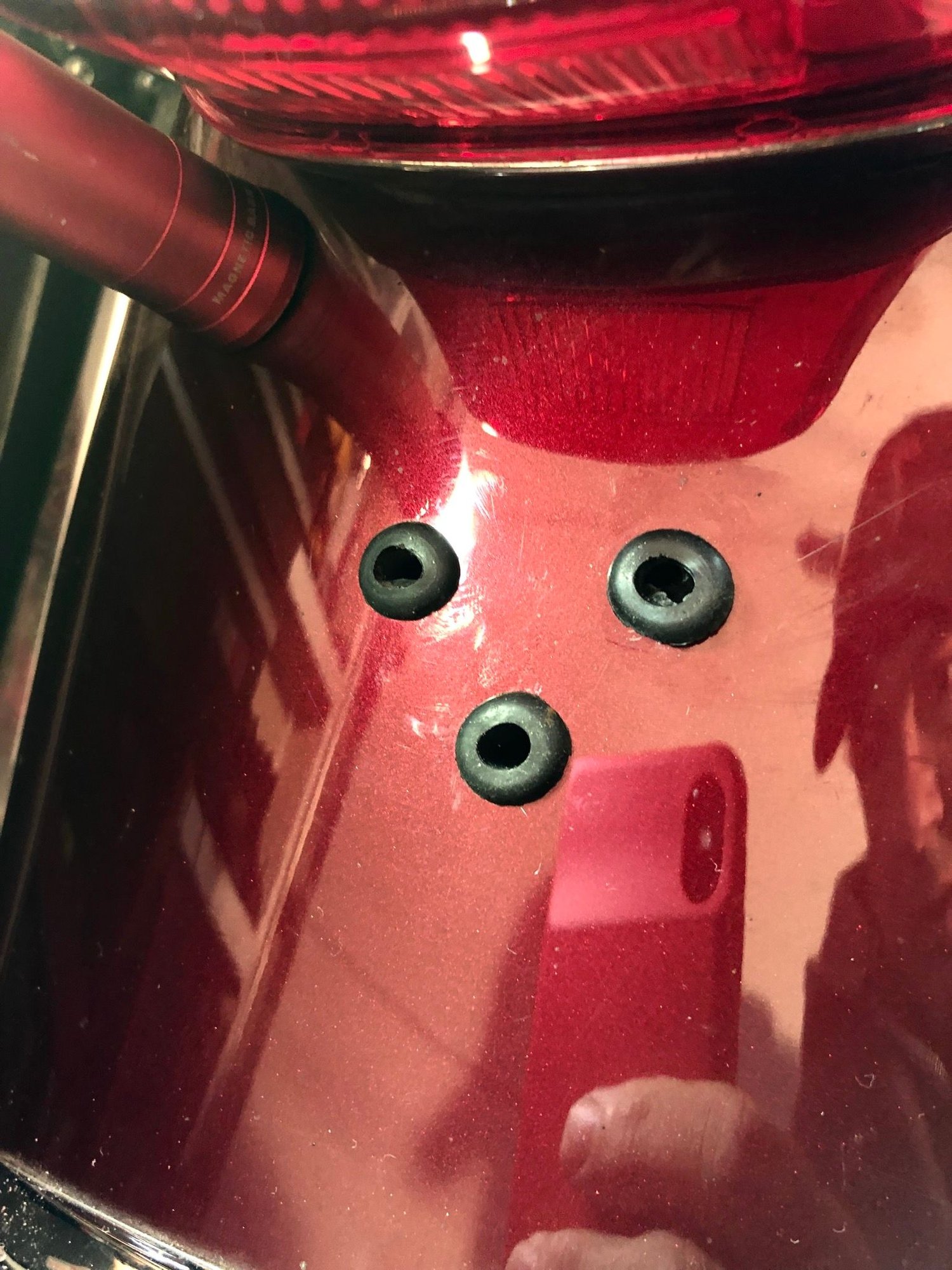

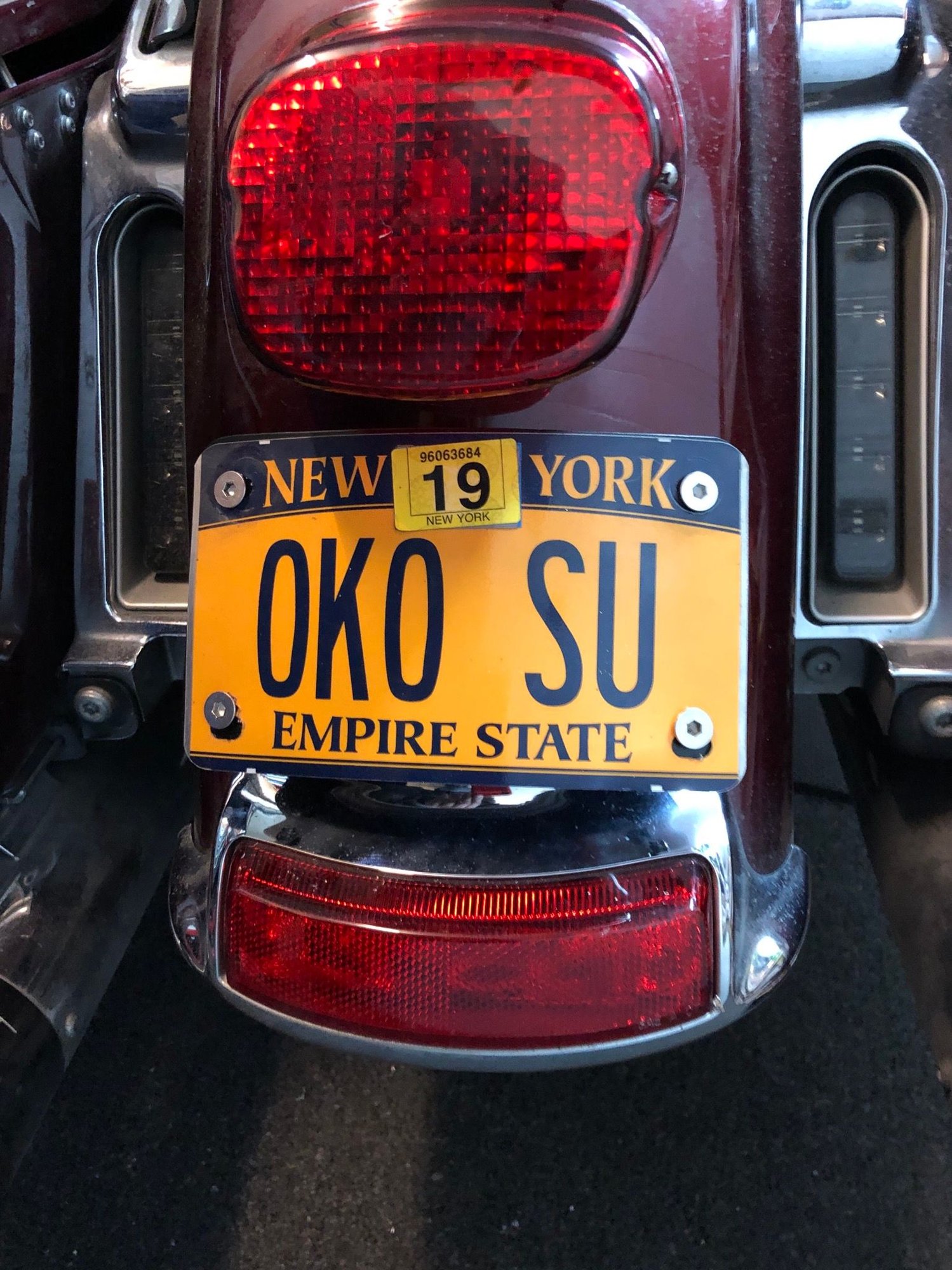

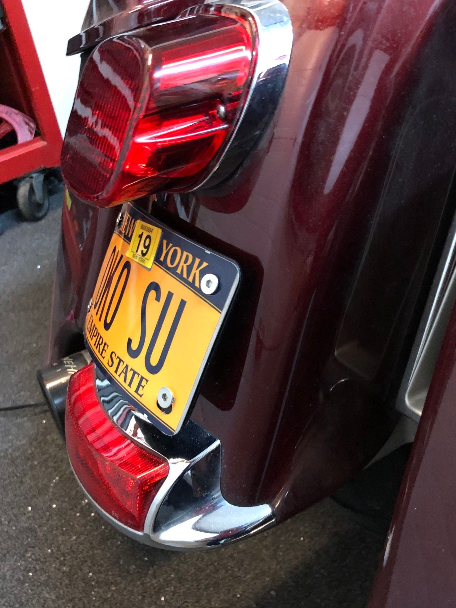

There are a few threads on this subject here.
For me, I drilled the holes. Then clear coated the metal. Then nice rubber grommets. Then a slightly bent plate frame and Viola!
And the replacement lens that is clear on the bottom.

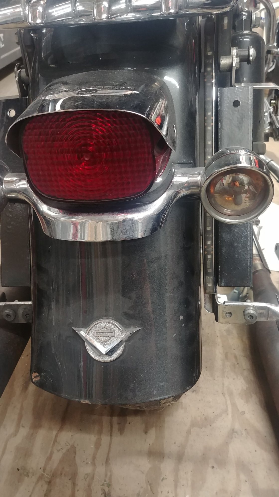

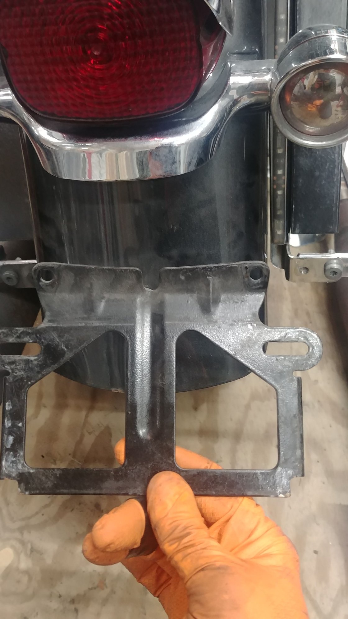

I recently did this to my 05 Road King.
OE bracket
Removed
New bracket installed.
