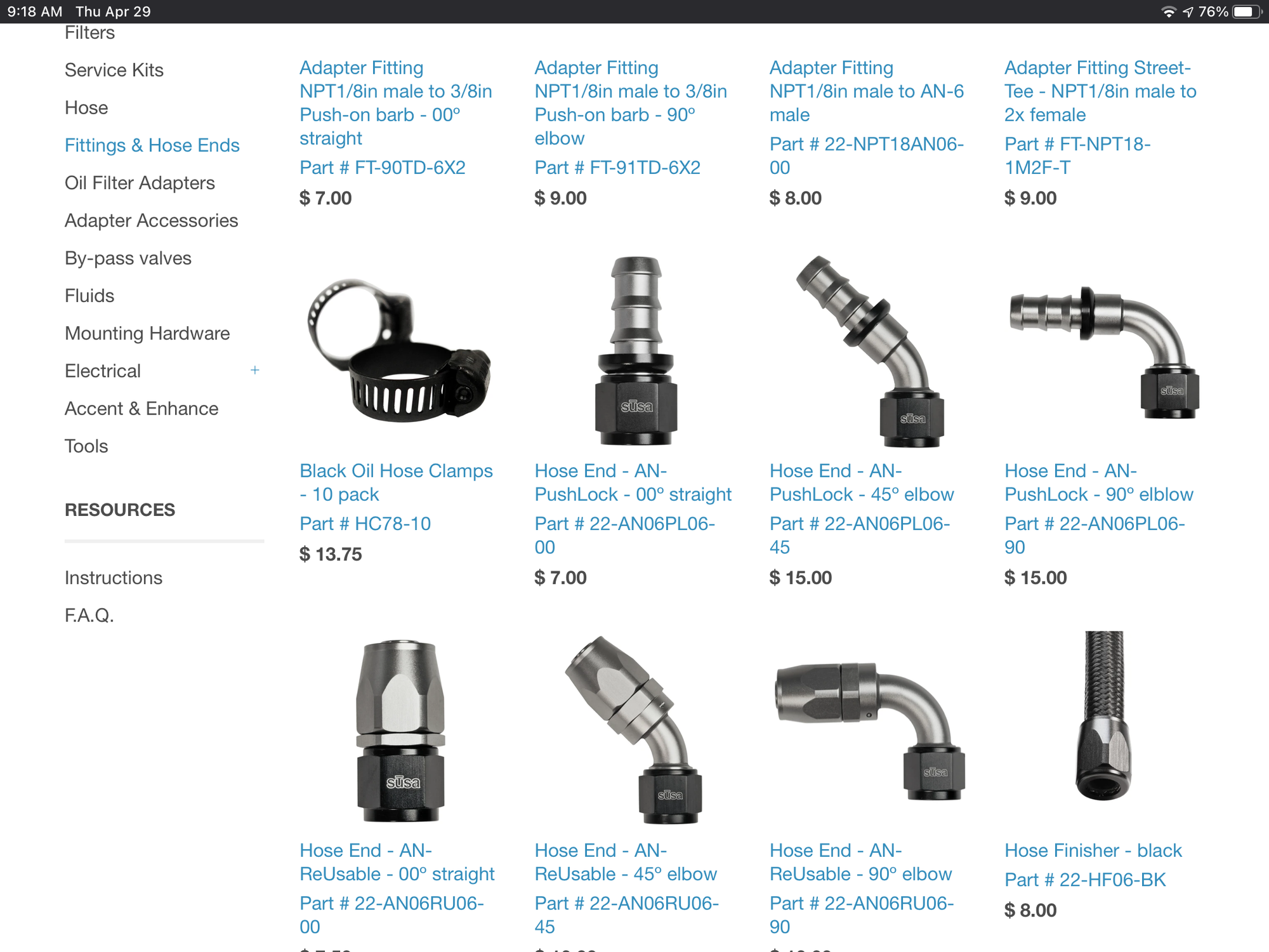

Thanks for those pics Sanman. I was hoping to get a kit with everything I needed when I order. I live in a rural area so I don't know where I would get custom hoses made. It is something to keep in mind though.
Like a lot of 96" touring bikes mine is leaking at the bottom junction of the engine cases, so I don't want to add any more potential leaks to the mix. Thinking along those lines I like the fittings that the UltraCool comes with.

Jag sells the fittings and hoses and their site.
https://jagg.com/collections/fittings-hose-ends
Also instructions for installation

Definitely get the AN fittings with a Jags cooler. I chased little oil leaks for weeks on my Jags before I finally got them stopped. The hoses that came with the kit did not fit the push on fittings tight enough to not leak, even with the clamps cranked down. I bought better hoses and stopped the leaks.
Thanks for that info dude. In looking at the Jagg and the UltraCool now I'm really starting to lean towards UltraCool. They seem to come with the proper fittings out of the box. To me Jagg knows they are shipping a defective kit if they offer "upgrade" parts after the purchase to fix problems.
