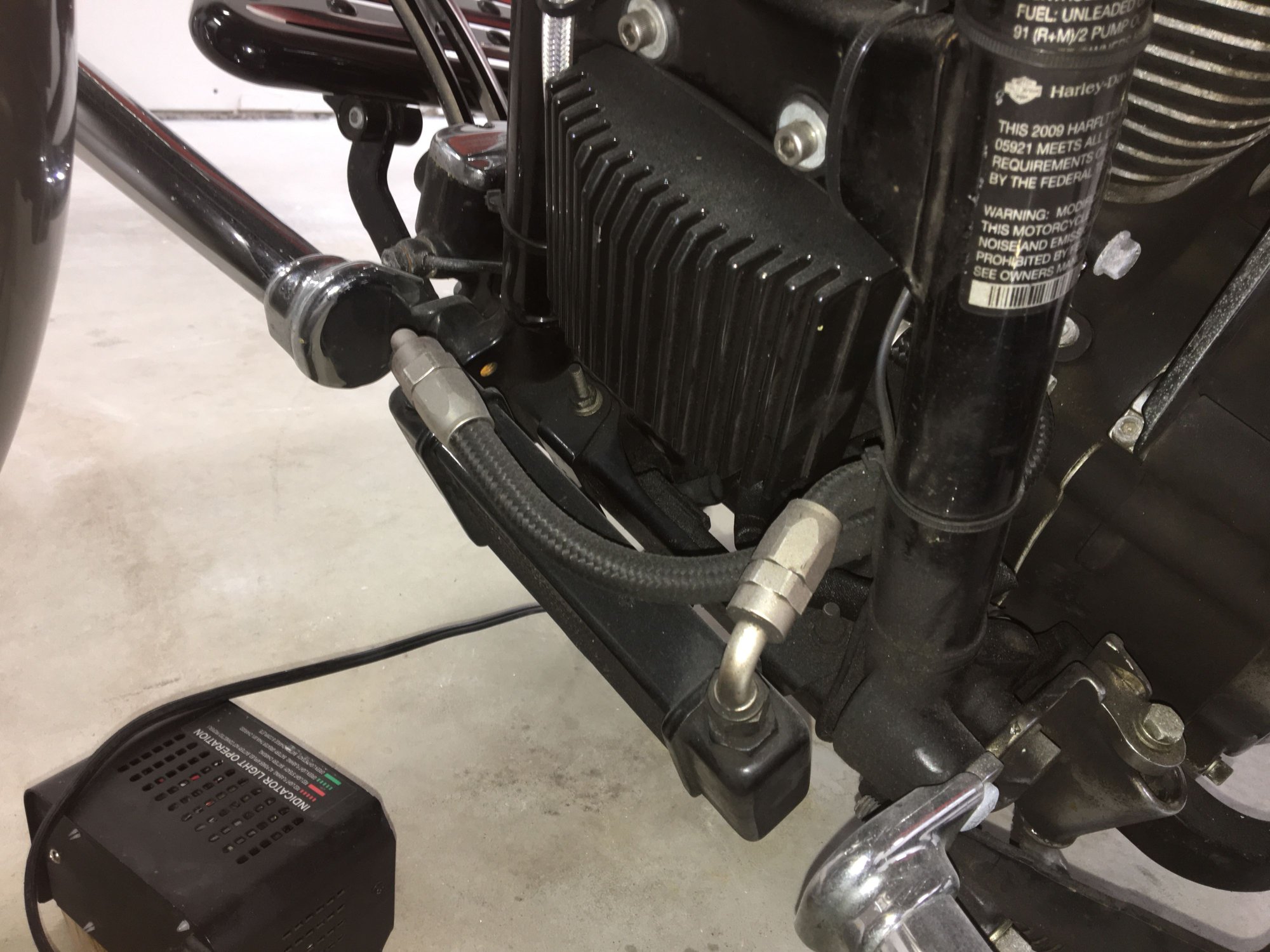

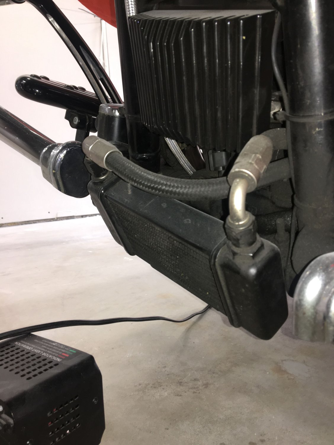

I’m using AN fittings on my jag. Also replaced the thermostat with one from Jason Ward. I’d have to go through my records to checks the specs on that since Jason is no longer in business.
