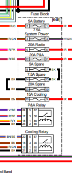

With ignition off can you measure 12v to grd at the system fuse. If so pull the fuse and see if the R/GN or V/GN is hot.

The top of the fuse should have 2 little slots you can test for voltage while the fuse is in place, one slot above each leg. If it has 12V, pull the fuse and check where each leg plugs into the holder.
Left side "should" be R/GN and Right side V/GN.
Oh and welcome to the Forum from Utah
The dotted lines are the fuse block
