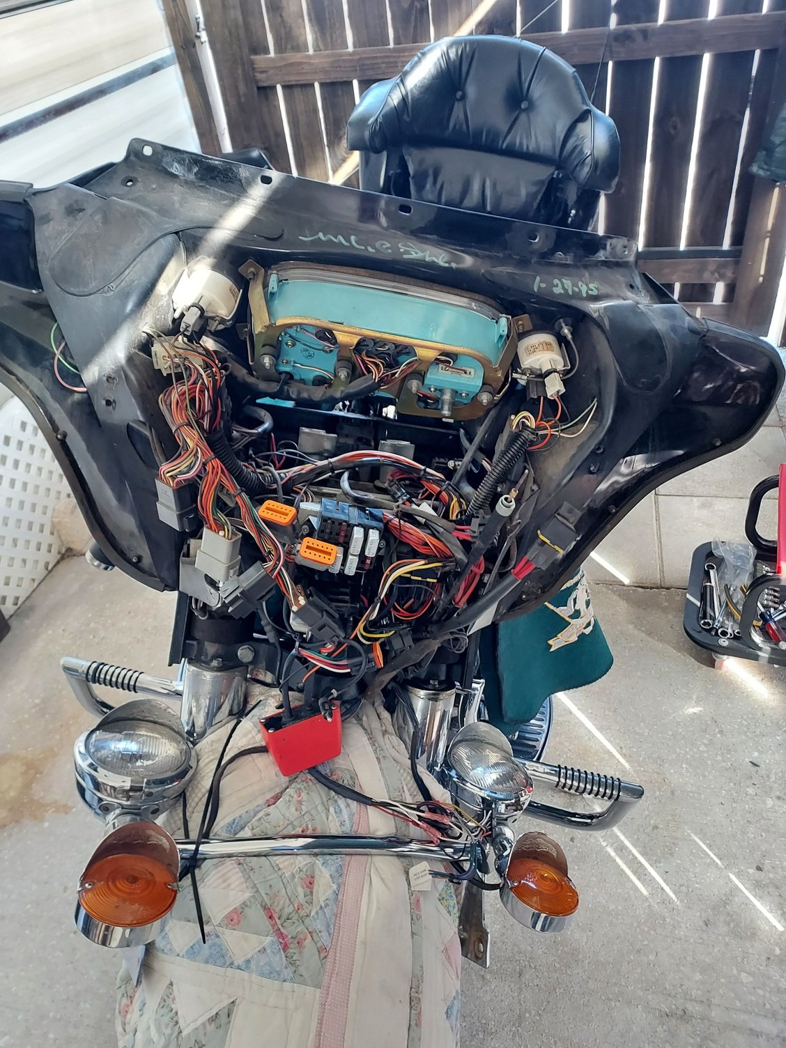

Can you believe this **** all of this just to put a new ignition switch in talk about being frustrated! I need a drink maybe more than one come to think of it! LOL

Wow.... that's a crazy amount of work to replace an ignition switch....
I'd hate to show you a pic from when I replaced the ignition switch on my 2016 Ultra Classic.... it was child's play in comparison...
But when it needs to be done..... slow and steady wins the race... !
Looks like you're doing a good job of it....
