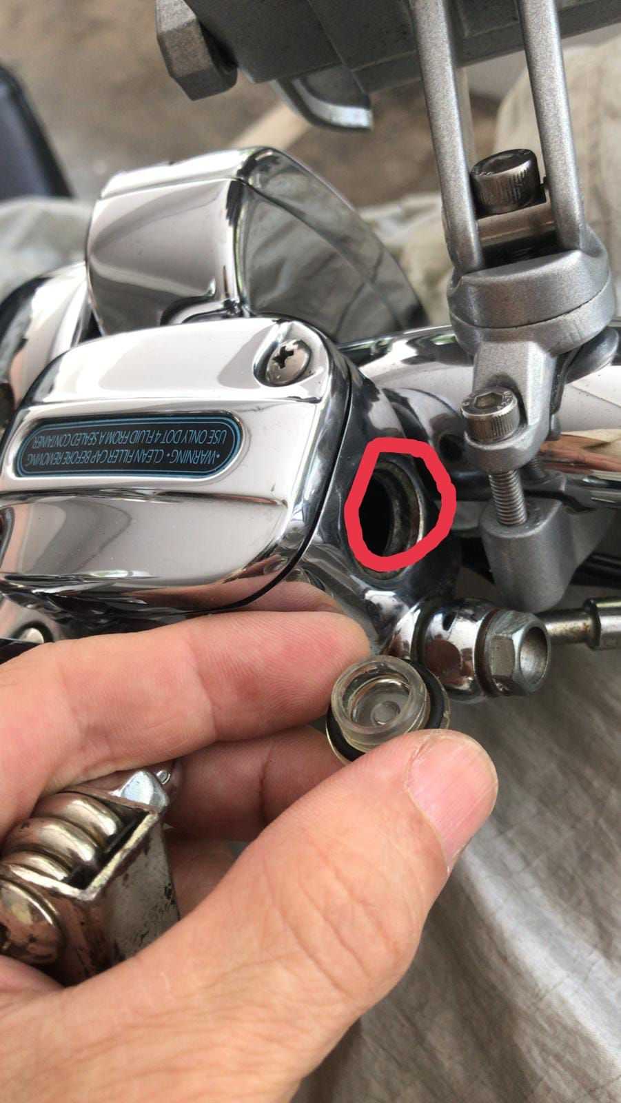

HI, I noticed brake fluid dripping down from my 2008 Road King FLHRSE4 front brake master cylinder. Made a check and noticed that the side window where we check the brake fluid level has corrosion and was leaking from there. I've double checked to make sure its not from the rubber seal that most problem came from. Does anyone has a quick fix on this problem or do I have to replace the whole brake lever assembly? Please help. Much thanks in advance.

I believe you will have to replace the master cylinder.

Try replacing the sight glass . . . 42854-06, comes with an o-ring and new glass. The corrosion is probably just the paint as the fluid ate it. Clean up the area and install new, repaint area

On a 2008 Master, although the sight glass may be available as a service item, you really might want to consider replacing the cylinder and lines if you have the $$$$
The rubber components have seen better days

This is what I found. Used some epoxy as a quick fix until I can make my trip to the dealer to find that part number given. I doubt they will have them in stock.

I missed the part where you said it was a CVO and see now it has chrome master cylinders. Remember to have the ABS cycled by dealer (or you if you happen to have a tool) when changing/bleeding the brakes.
