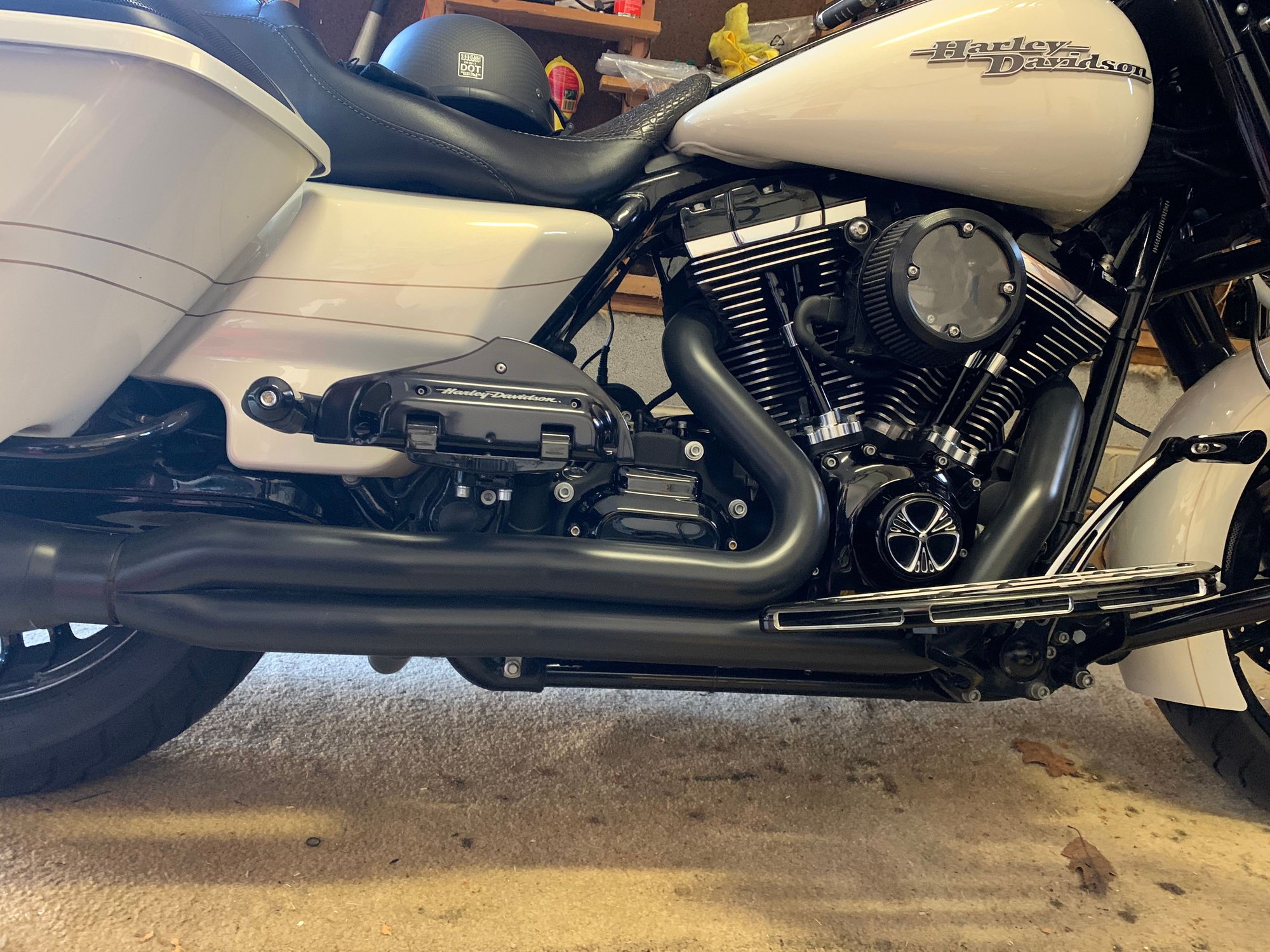

Yes, both HD and Kuryakyn have them: https://www.kuryakyn.com/products/15...passenger-pegs
these are mine:
