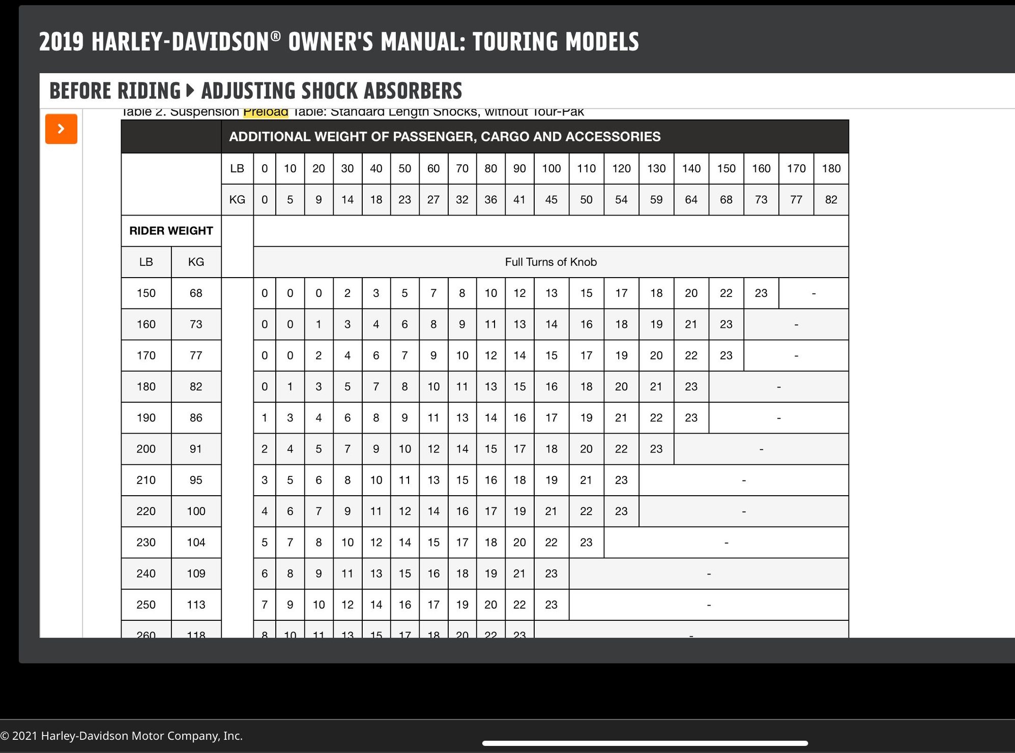

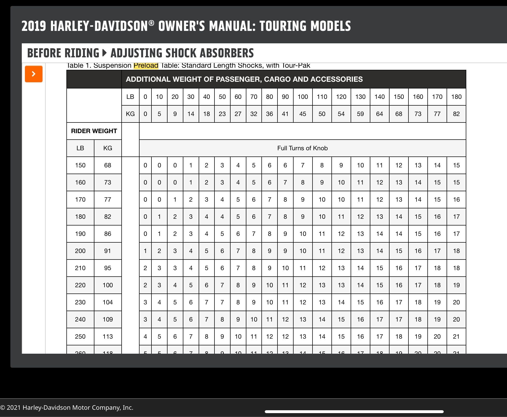

I’ve always complained that the suspension on my 2019 Road King isn’t great and doesn’t soak up the bumps very well, and someone recently asked if I’d got the preload set right. I ‘knew’ I had as I’d set it as per the manual. However, I’ve just decided to double check and I’m now wondering if the UK online manual is wrong. The reason that I say that is that there are three tables, one with standard shock and tour pak, one with standard shock at without tour pak, and one with low length shocks with and without tour pak.
If I check the table and go to my weight (*cough* 270lbs *cough*) on the table WITH tour pak it says preload of 5, but on the table WITHOUT tour pak it says preload 9. Why would you need more preload with just rider and no tour pak, surely it should be the other way around as you’d need more preload with tour pak to compensate for the weight of the tour pak?
Based on the table I’ve been running a preload of 9, but maybe I should be running it at 5 and this is why I’ve always found the ride harsh?
(Sorry 270 is missing off the bottom of the tables below, but I thought it more important to show the bit at the top showing with or without tour pak. You can see it’s suggesting more preload with rider only though)

The US one is the same way, ironically I started looking at it this week because I forgot I even had the adjustment and I've been thinking the rides been shitty and I've been getting beat up. Also, I just put on my tour pack for the first time recently lol
I dont quite folow the logic there either, I assumed something to do with weight distribution and geometry, but subscribing anyway

Well I've tried lowering it to 5 and I think it's worse, I seem to get 'jiggled around' a lot more
Originally Posted by Red
Disregard the chart. At least that's what I've figured out over the years.
I run my dressers at 0 unless one of the big girls is with me. Then I go up to 8.
I'm 225lbs and can't remember bottoming out the 13" hand adjustable shocks.
Thanks. As above I changed it from 9 to 5 and I think it's worth, but I'll try 0 out of curiosity

I just looked at the online manual for 2016 Touring Models equipped with hand adjustable shocks. It has similar preload tables for models with, or without Tour Paks, but it makes more sense (to me) than the 2019 manual. Models with Tour Paks have higher preload numbers, versus models without Tour Paks.
