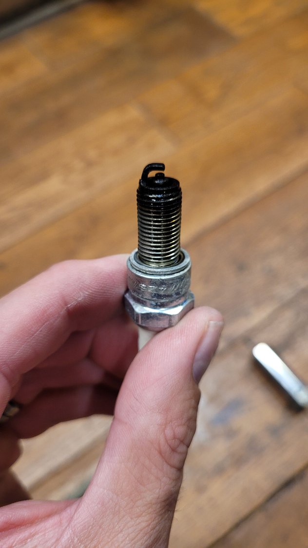

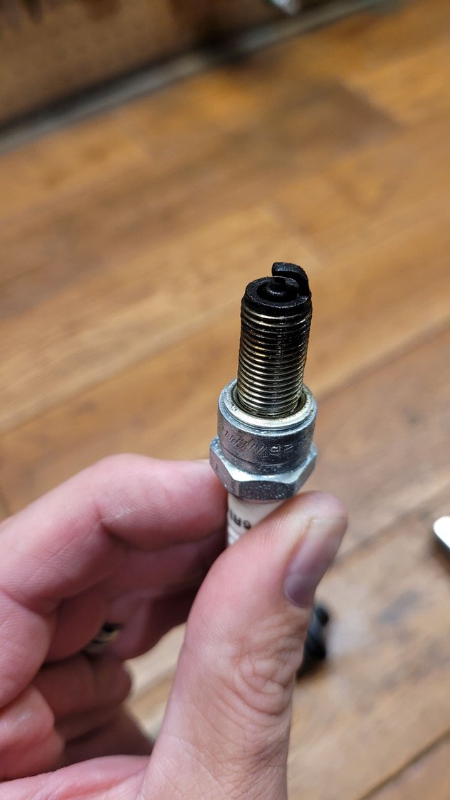

Default Plugs
Attached are images of the plugs, genuinely not how I'd expect them to look. And the oil is quite low.

You next step is to pull the crank sensor and see how much oil comes out, and find a way to measure it.

Plugs are nasty! How many miles on it?

It's sumping more than likely, I would bet it doesn't have the 8 lobe oil pump in it. If you are still under warranty I would get it in to the dealer ASAP.
