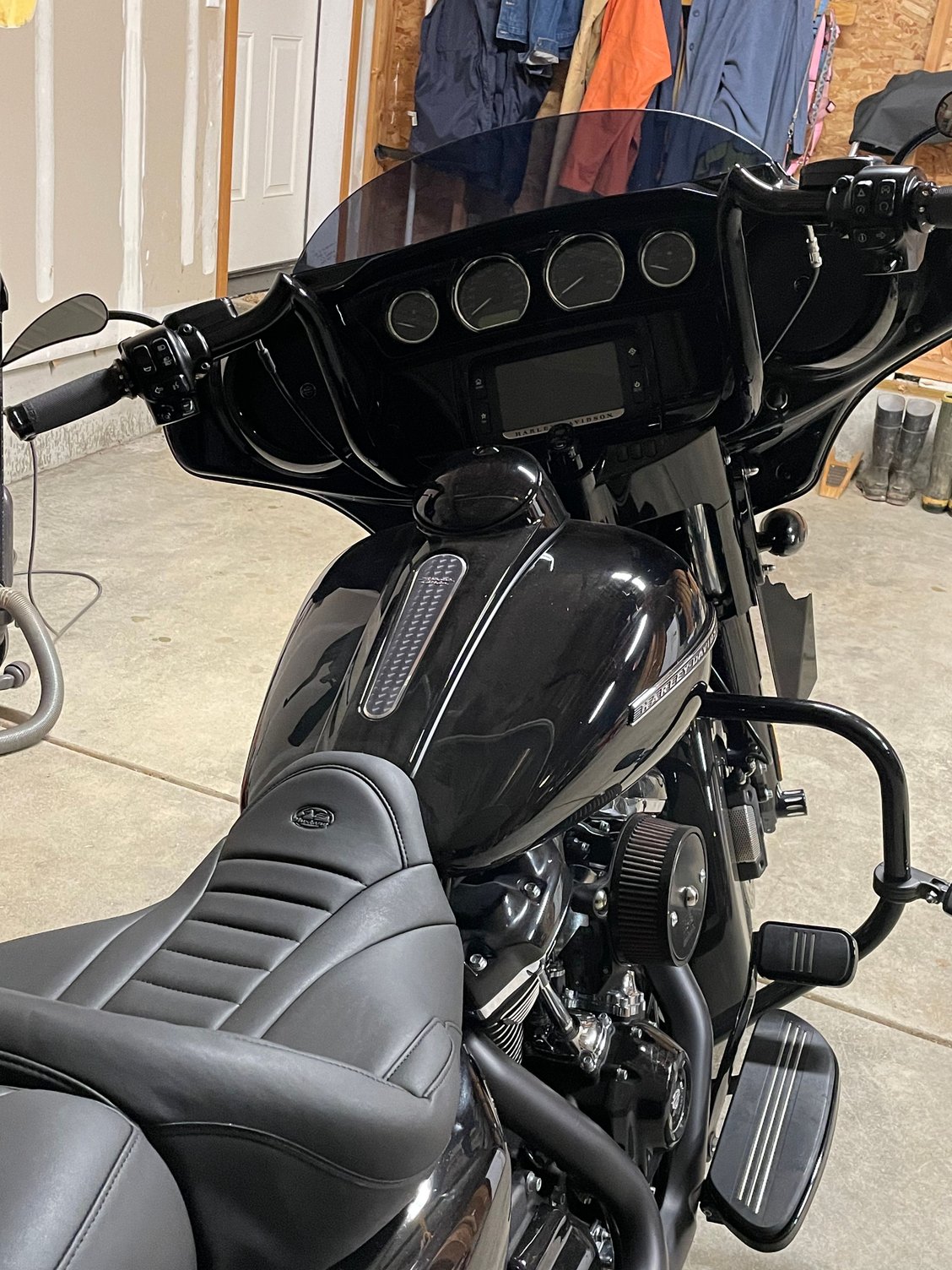

Old Aug 11, 2021 | 11:52 PM
imboden's Avatar
imboden
Joined: Feb 2005
Posts: 2,967
Likes: 94
Old Aug 12, 2021 | 05:06 AM
jessultra's Avatar
jessultra
Joined: Sep 2007
Posts: 1,099
Likes: 155
From: pittsburgh,pa
Looks good . 12's ?
Old Aug 12, 2021 | 09:28 AM
imboden's Avatar
imboden
Joined: Feb 2005
Posts: 2,967
Likes: 94
Yeah 12s.
ive never had anything but drag bars or T bars, or pull back T bars.
so this will take a lil adjusting
