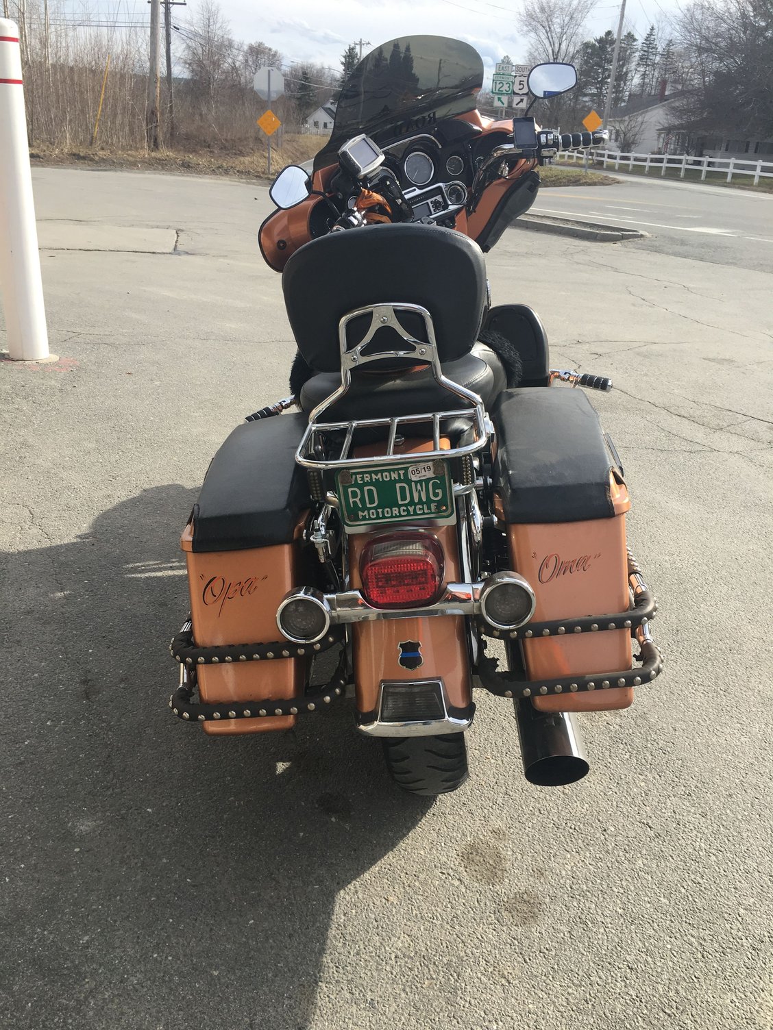

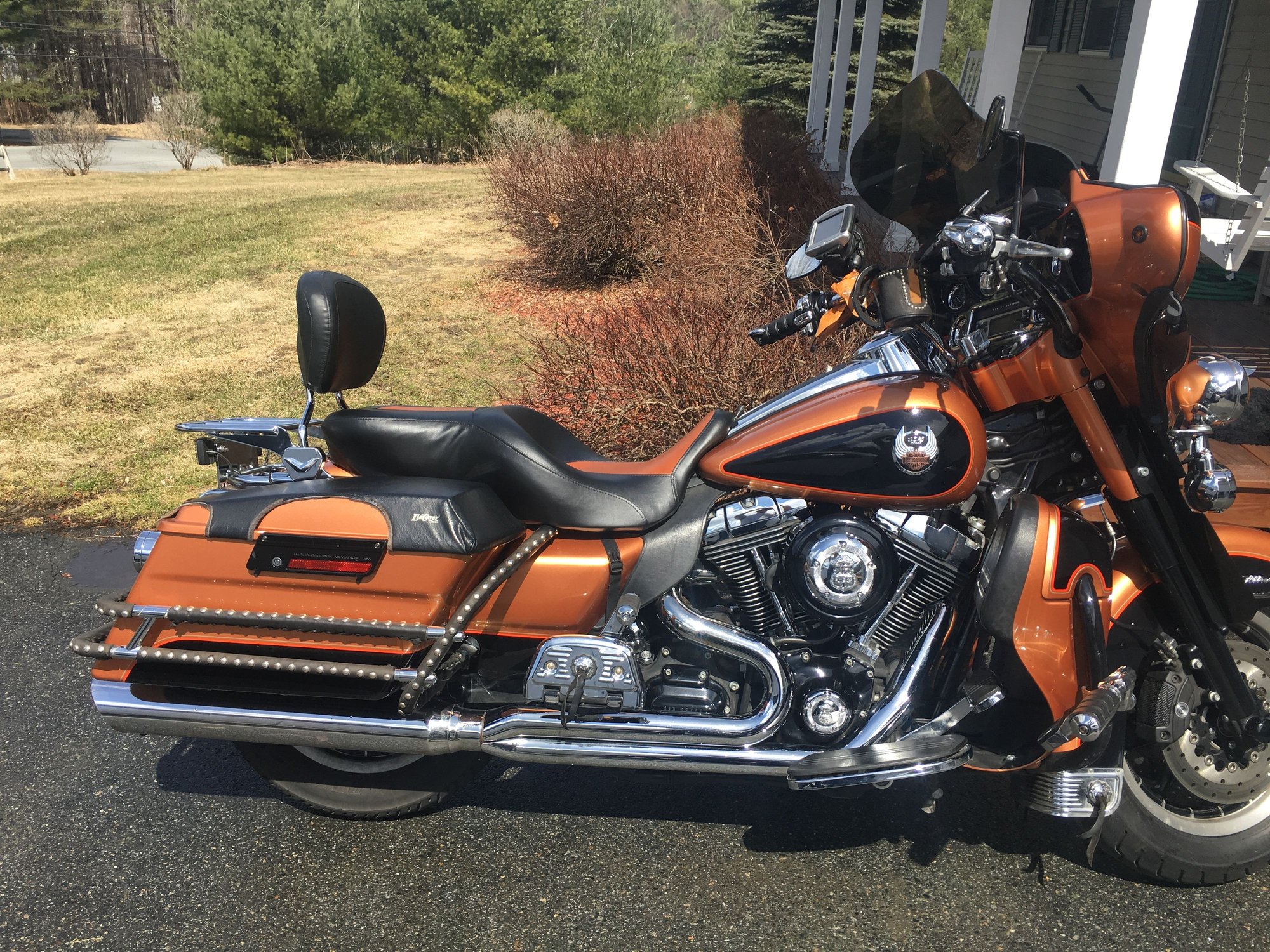

It says that because they don’t make the wiring quick connect on the ultras. You can do it yourself and use the 97-08 detach kit and you’ll be fine. I did it with my 08.
