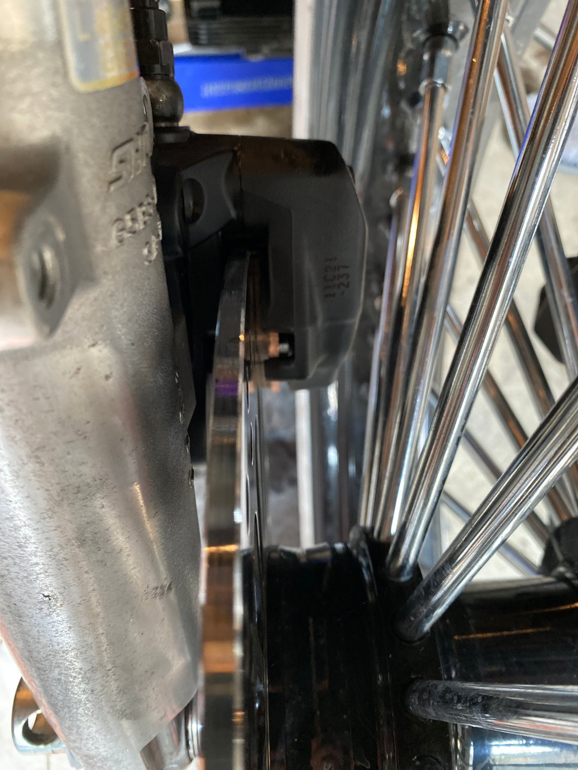

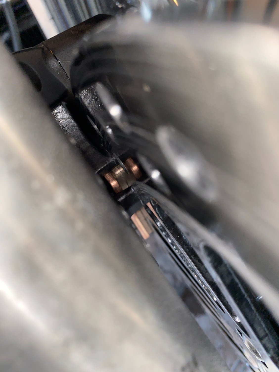

I recently got a new 21in wheel on my 2011 SG w/ abs. When I put it on, I put new brake pads on but now the caliper is actually dragging the rotor. It seems like the whole wheel needs shifted +\- 1/16 of an inch to the clutch side of the bike. I reckon I put the front axle assembly back correctly.
axle, spacer with machine marks out, bearing, bearing, wheel speed sensor, bushing, washer, nut.
I’ve read some other forums and tried some of the the suggestions people have given but I’m still hung up. Any solutions?
Inside of brake lever side. (Plenty of room)
Side that’s dragging (outside, brake lever side)

Pretty obvious you need two correct spacers. Was your new wheel designed fro ABS? Did you bottom correct side of wheel with the first bearing installed. Remember, that other side does not bottom. It's pressed and stops on inner spacer. Torque goes thru center. If it didn't work that way, torque for axle would be on races.
In service manual. I don't have it in my head. It's not a lot different but done wrong doubles the error.

The bearings were already set when I got the wheel. Just from eyeballing it, it looks as if they’re set right compared to the stock wheel.

Very hard to see that little amount unless you measure. Was the center to center to the outboard races thru the hub the same?
Take your old wheel and measure bearing race to machined outer face on aluminum on each side. Is there a difference?

I just measured it. It was the bearing. Stock wheel fits as it should, no drag.
