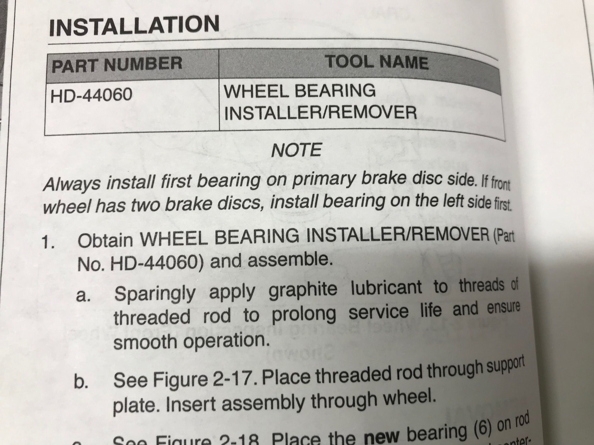

A lot of confusion comes from HD's use of the word "Primary" when discussing wheel bearings. It has nothing to do with the "Primary Case." "Primary Bearing" is the one that gets bottomed first in the wheel.

Multihdrdr & F86 are correct. (I knew they would be)
Upon re-reviewing the FSM is does indeed state to begin with the primary side which is the brake disc side.
I guess I just got lucky with my rear wheel because I def did the left side first. I hope this thread keeps someone else from doing it wrong.
