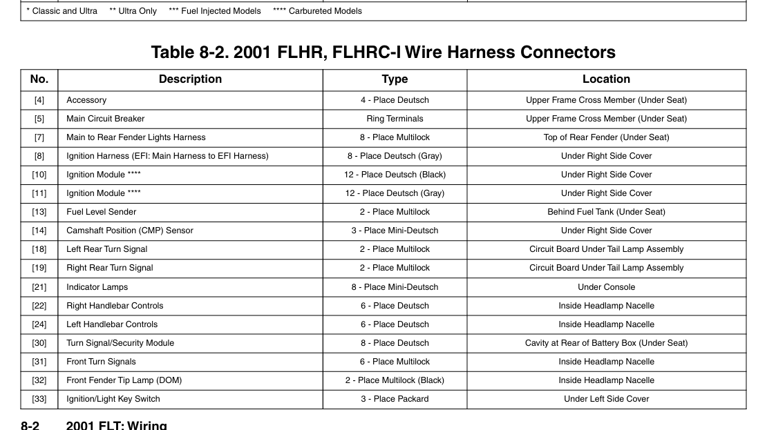

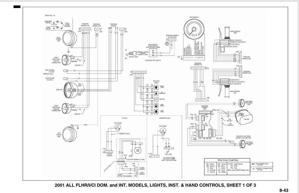

From 2001 manual, you can look at what connectors are in the Nacelle.
