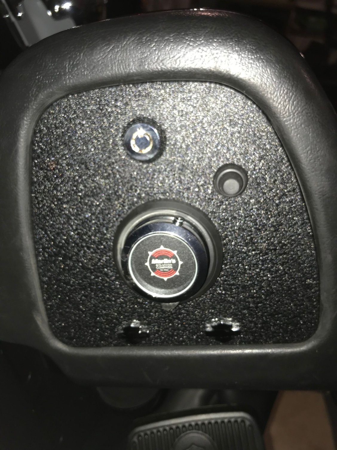

https://www.amazon.com/dp/B07PMSPXMG/ref=cm_sw_em_r_mt_dp_30WE7RNAJHD2NH95Z21R?_encoding=UTF8&psc=1 https://www.amazon.com/dp/B07PMSPXMG/ref=cm_sw_em_r_mt_dp_30WE7RNAJHD2NH95Z21R?_encoding=UTF8&psc=1
A little 3M two sided molding tape, and a zip tie as a failsafe. Mounted inside the dash panel, and the zip tie loosely around the switch blanks incase the tape fails. Temporary, easy to remove, hidden, easy to use, effective, cheap.

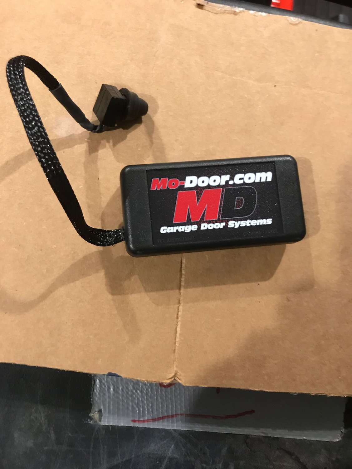

I have had good luck with this.
