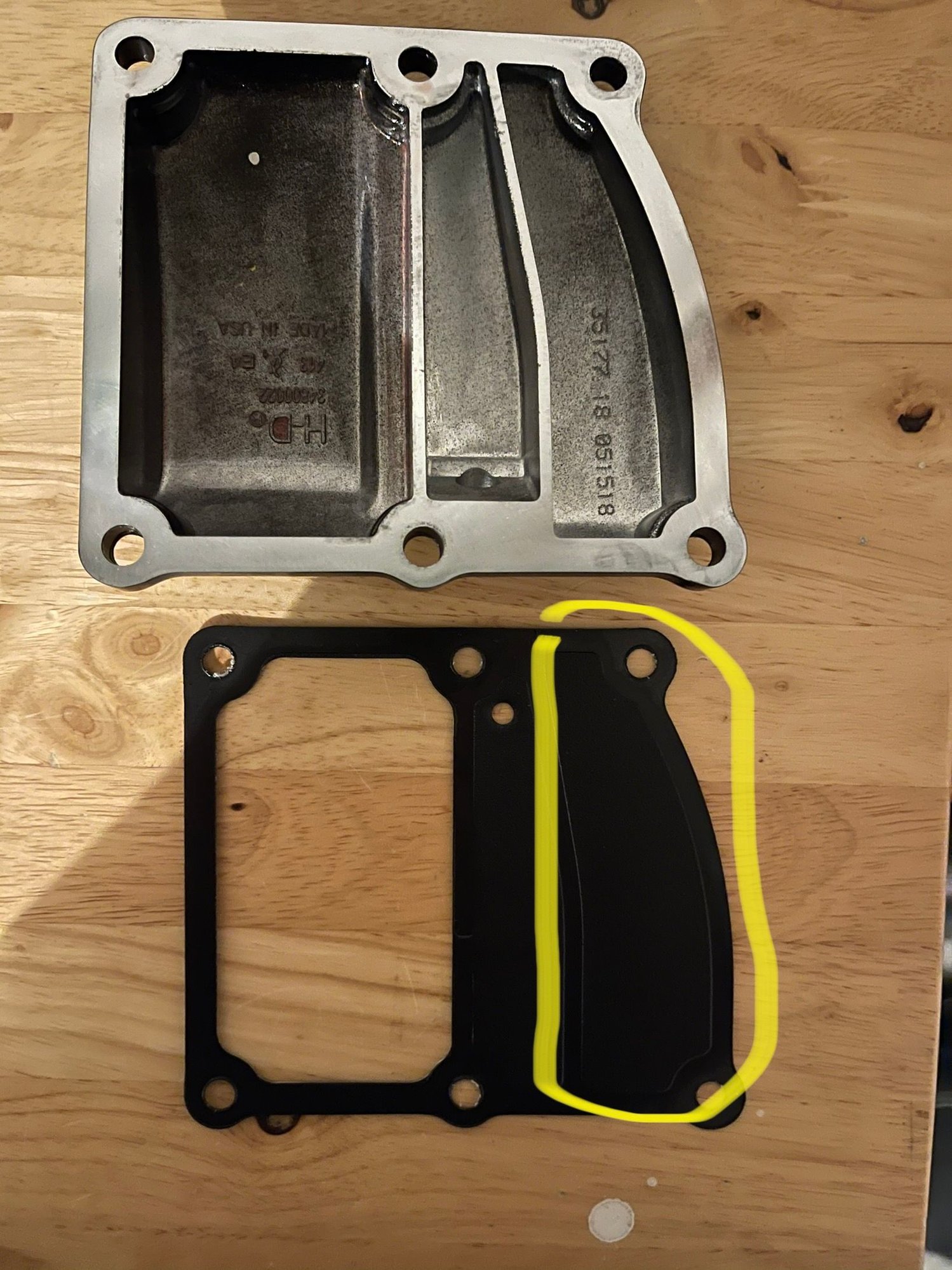

Originally Posted by Road2020turbo
both are same design
OEM and Trask gasket are not the same, oem has the crank section sealed off and trask gasket is open which allows it to vent to the reed valve

Originally Posted by klammer76
This is the gasket that came on my Trask CheckM8 that I installed last week on my 2021. Same gasket that was on the stock oem cover. No issues.
Trask
OEM
The yellow area is what is different on the oem gasket.

Originally Posted by Quik
Trask
OEM
2021 RGS stock OEM trans top and gasket.
Copy that, was not aware that the 21 gasket had changed and opened that section up. Looks like a completely different style of gasket to previous models also (grooved cut out vs flat style)
