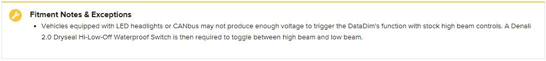

I thought I had settled on a pair of Clearwater Ericas, then started looking at their Sevina or Dixi lights, but then started looking at the more economical Denali D7's. However, the D7's apparently will not play well with my bike that came with an OEM LED headlight. I'd prefer that these additional lights switch to full power when I switch to high beam.
Although, I also wonder if the Clearwaters will even play well with my bike when I switch to high beam as they also offer this note: "*Some bikes with LED headlights will not have the high beam feature."

This may help
