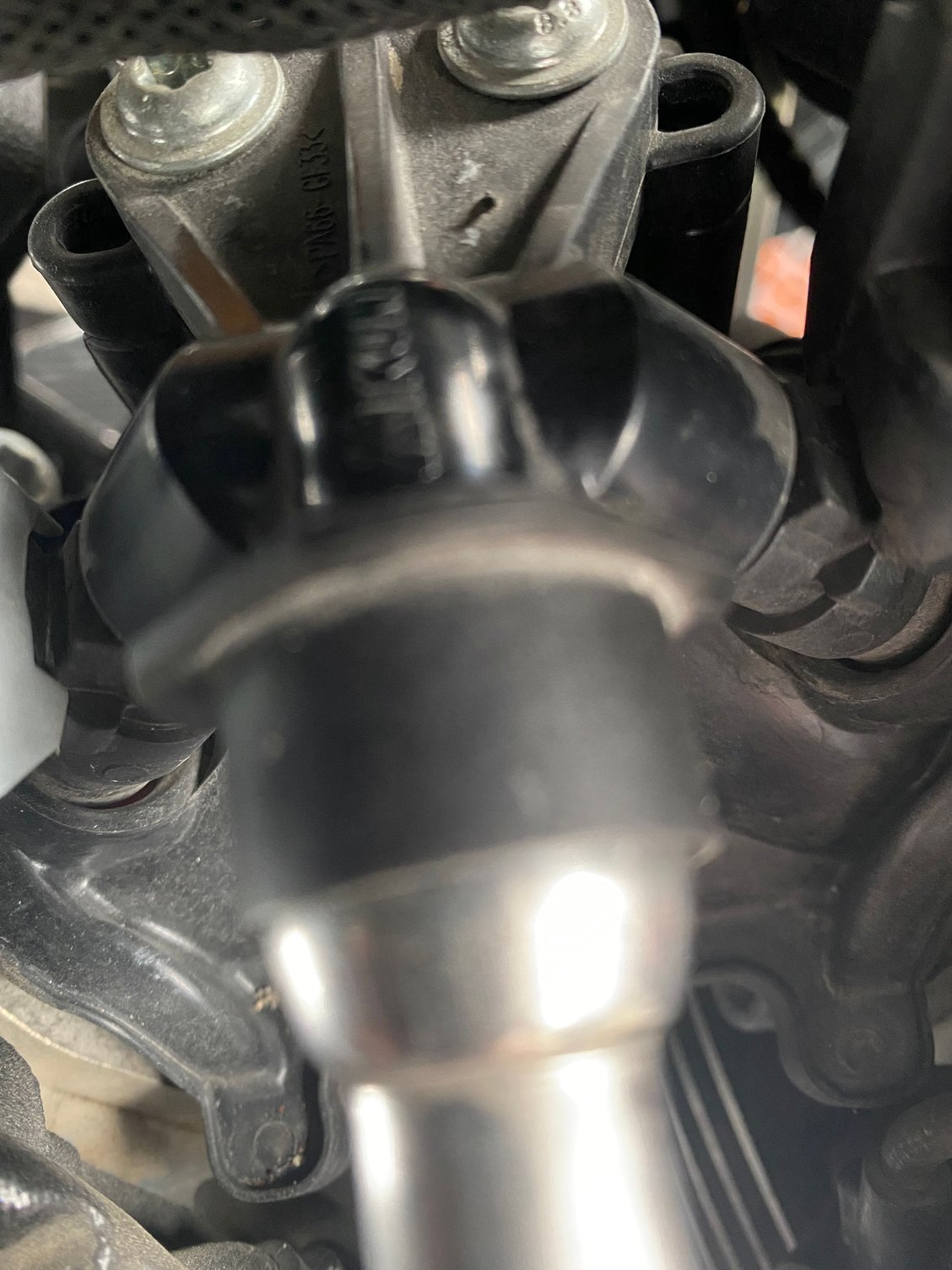

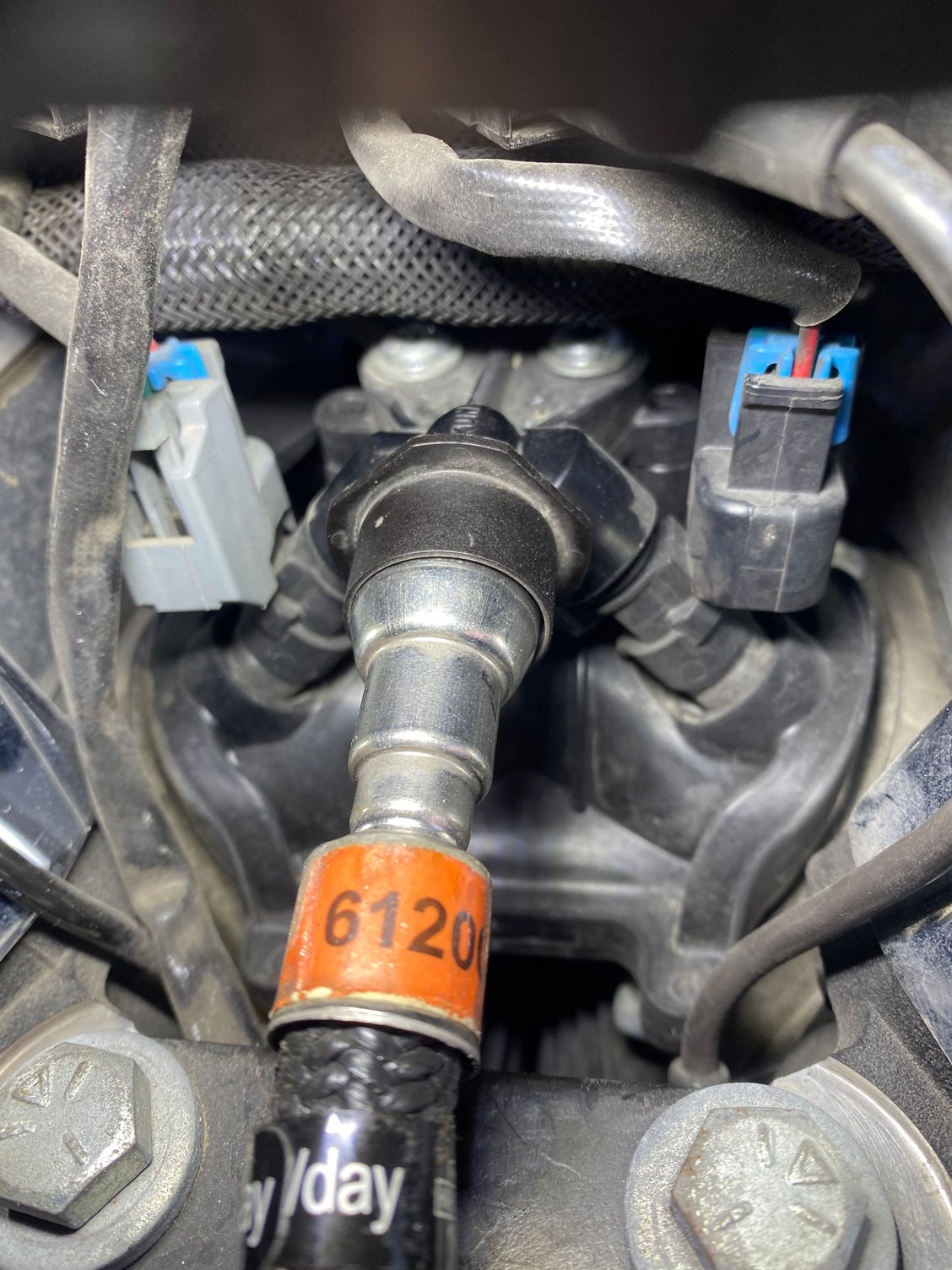

Hey everyone! Need some help. i have a 2017road King. Fuel line started leaking after a plug change. Yes i did do the o ring replacement. I got a new line, but can not remove the injector side of the old line. Went to local Harley and they actually scratched their heads. Any help would I will be very grateful.

If you push the hose itself towards the fuel injectors, then pull back on the collar at the same ( red arrows) the hose should release.
