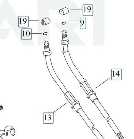

What's the trick for removing the cables OUT OF the housing? The ends and brass ferrules are out but how do i remove the cables completely?

Just pull them straight down. They are held in place by circlips (#9 & #10). The circlips will remain on the cables.

Ok I got it. Had to pull a little harder to remove but they did pop out. Anyway some people talk about how EASY this is but I see it different since I had to remove the rh nacelle just to cut a big TIEWRAP that someone(factory) had installed on the cables I guess to keep them from moving around. The gas tank issue is easy. Just lift it a couple of inches at the front.
I guess I'll add the tie wrap back since it was there before I touched it.
