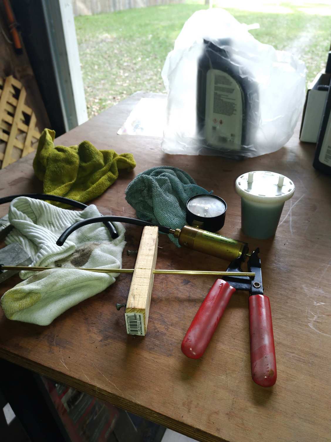

Home made " special tool "
That is quite ingenius! I'm stealing it for the next time I am going through forks.

Glad to share. I just can't bring myself to buy a tool for only a few uses. Specially when one can be put together with other tooling I already have.
