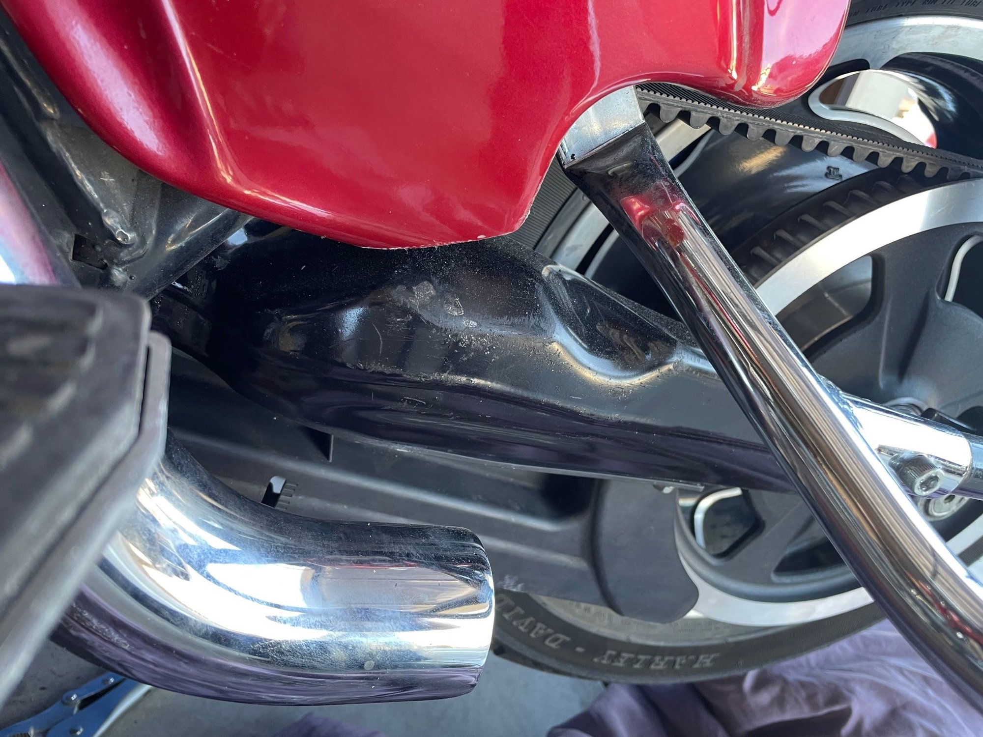

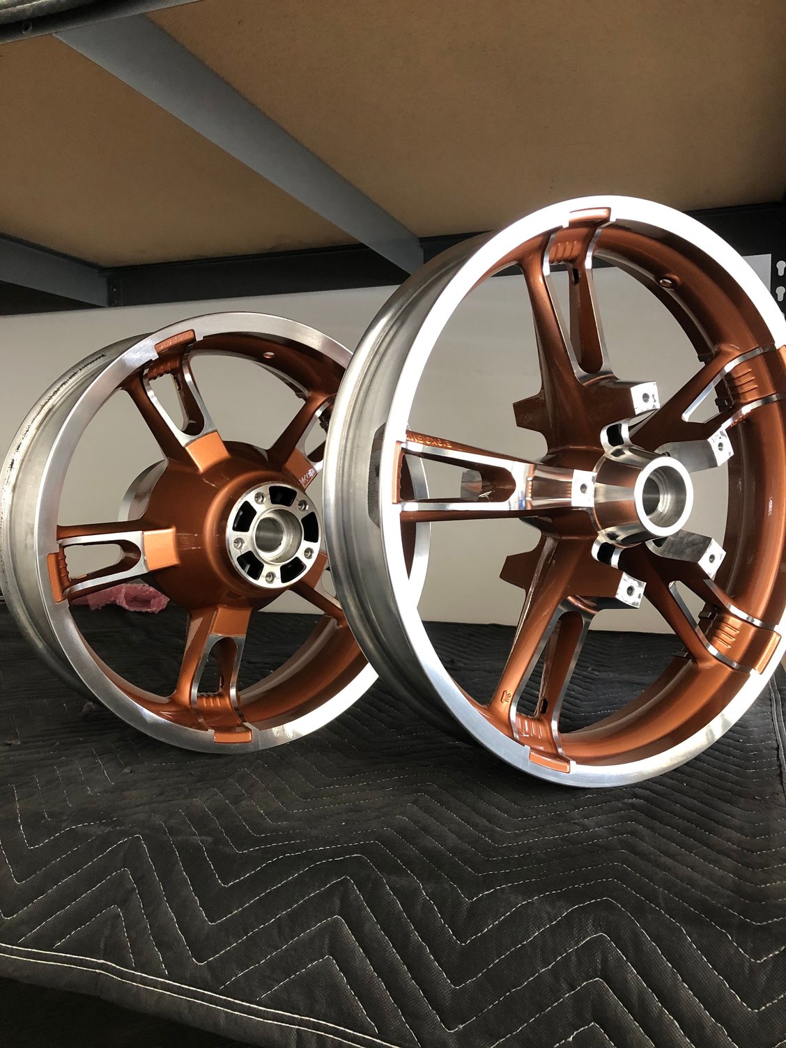

Merry Christmas all. I just had a set of Enforcers paint matched to my ‘08 Anniversary Ultra. I know the front will bolt on but the rear is too wide. Can I swap on the ‘09 swing arm or will the rest of the driveline be misaligned?

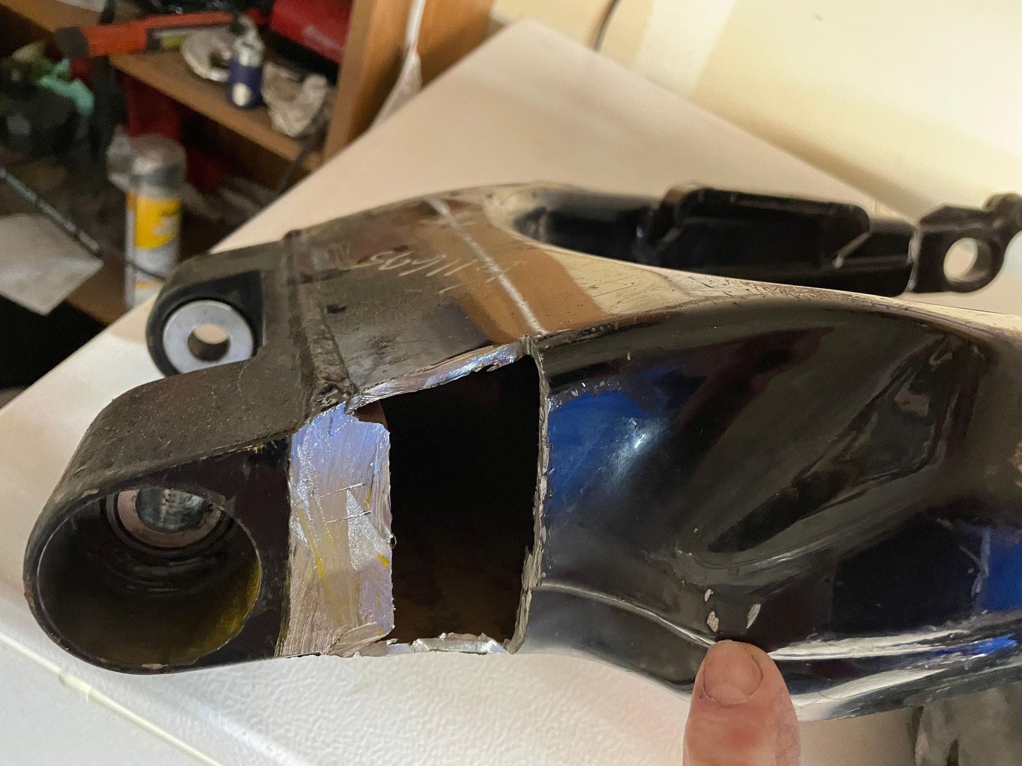

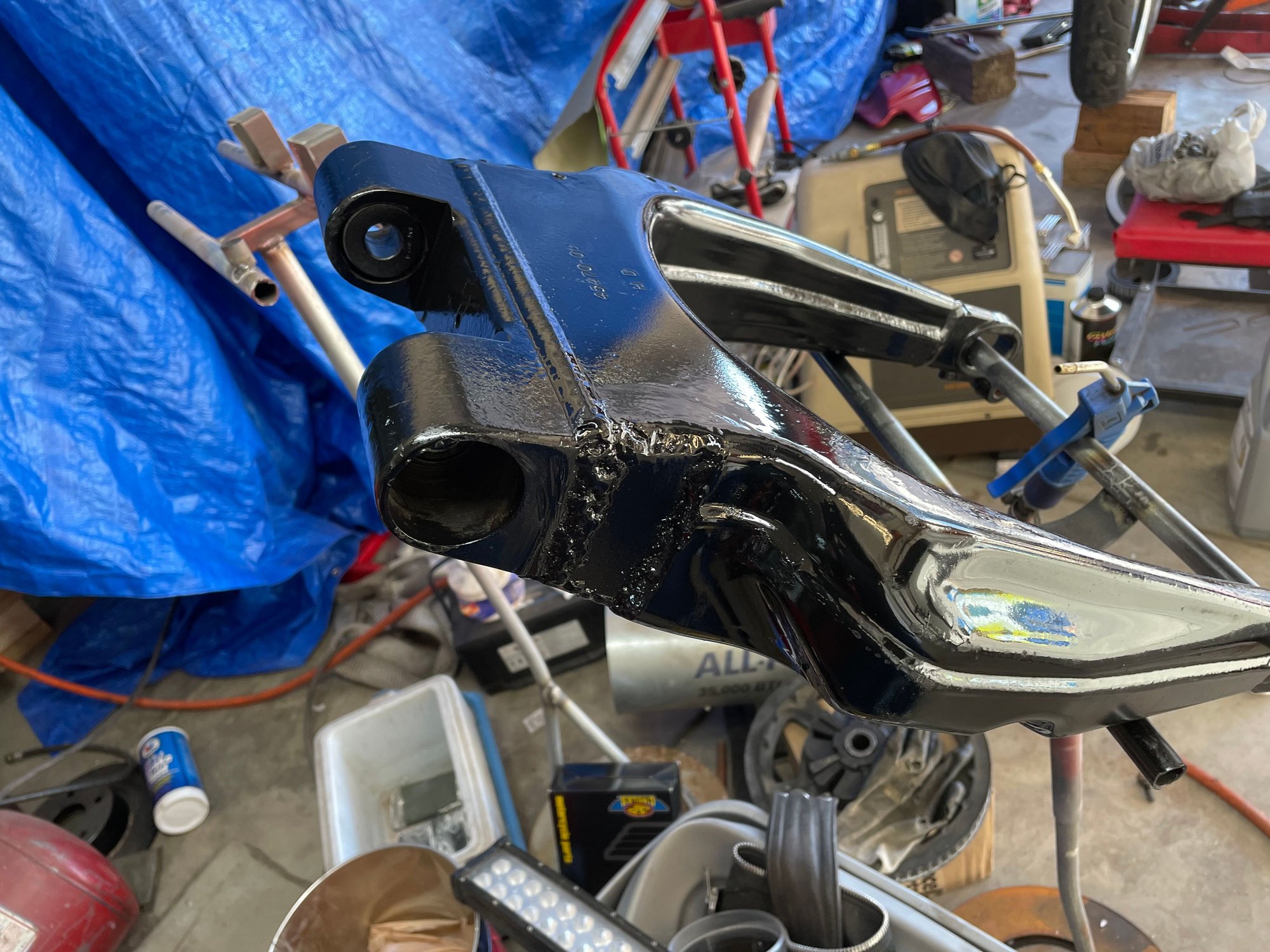

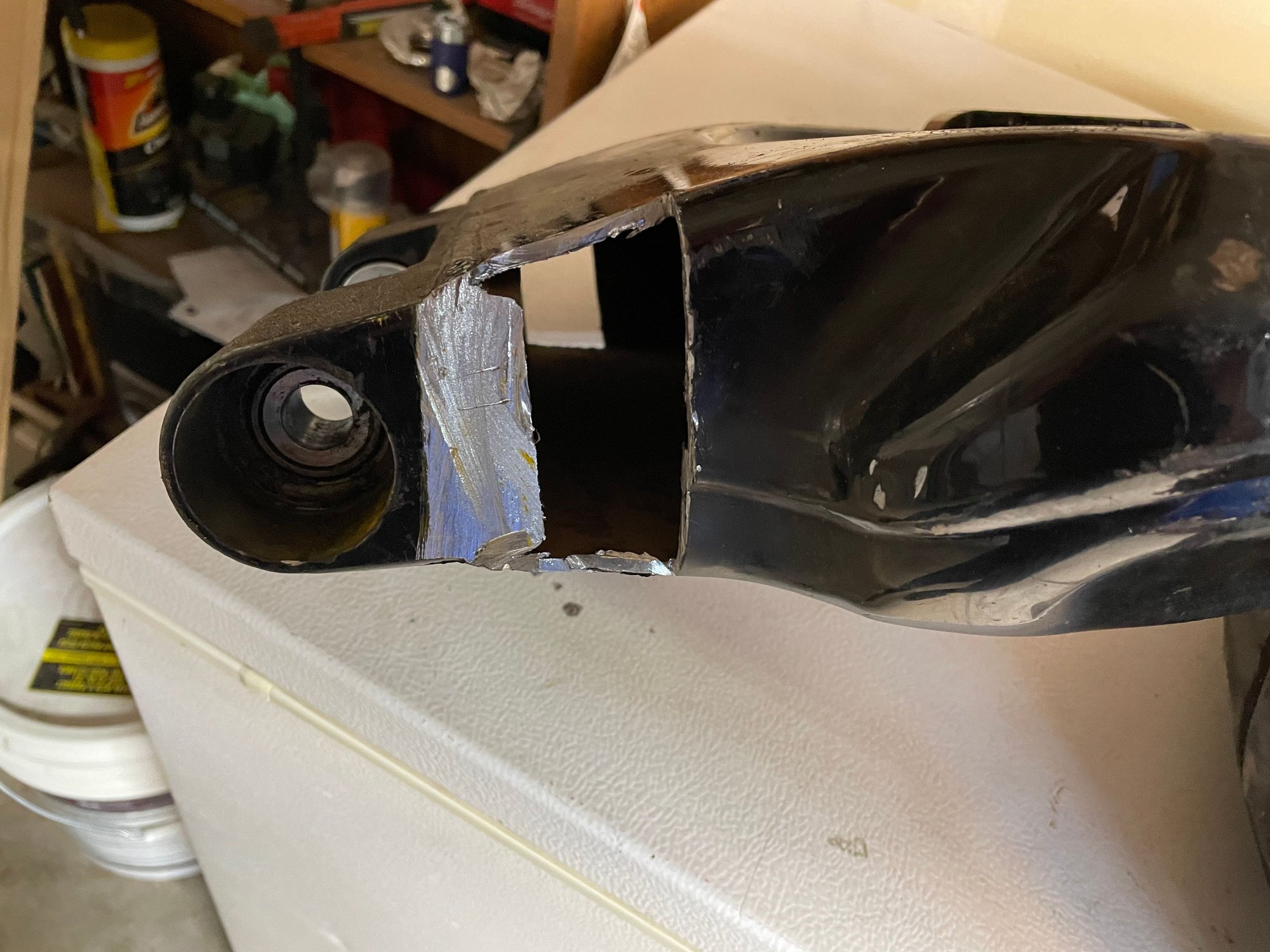

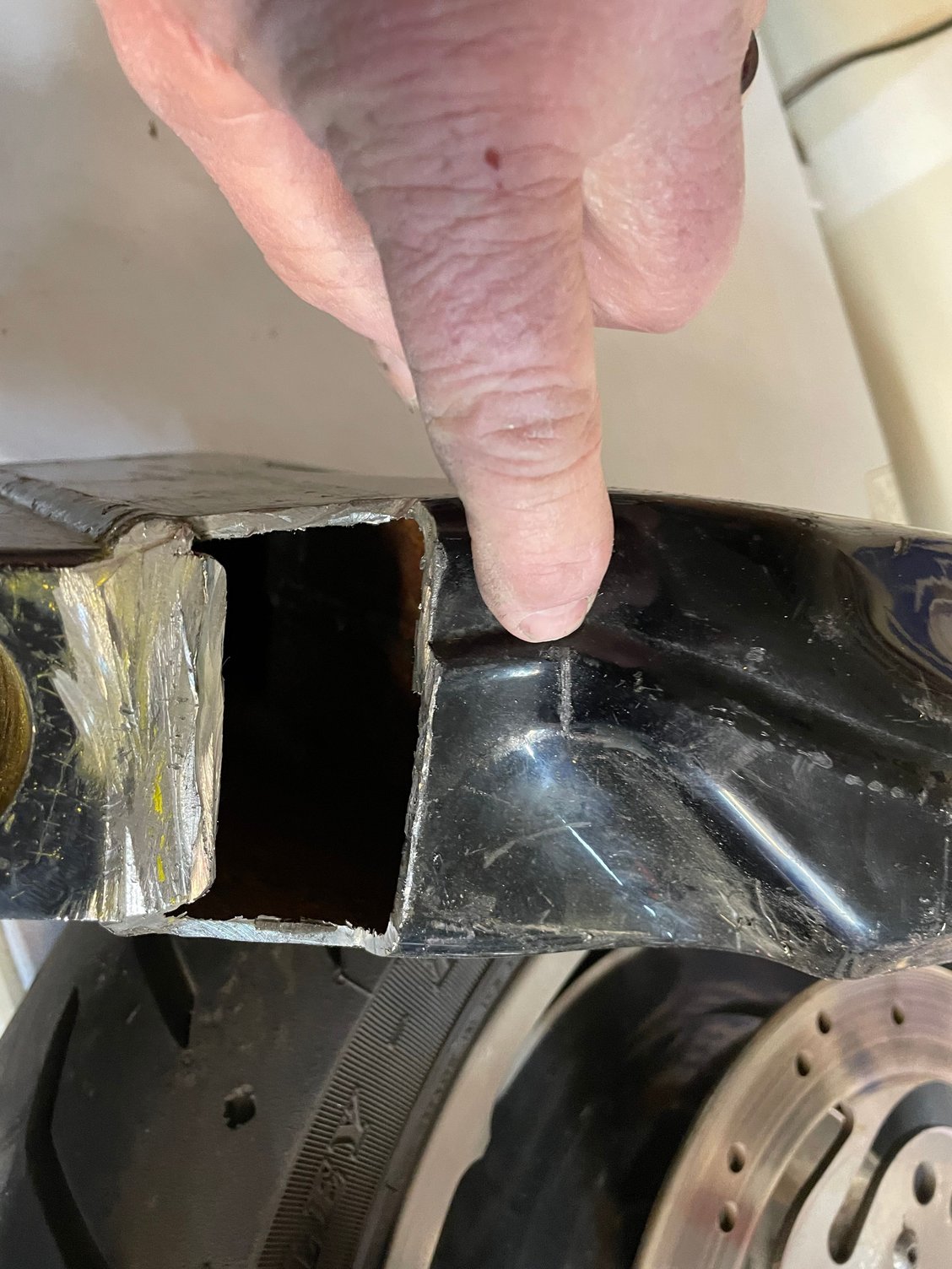

The 09 up will fit if you trim the end that goes to the transmission.
Then weld in some plate steel so it is flat in that area.
This will allow the arm to fit, but you will have to modify the fender to fit the tire as well. I did mine like Timberland did, it is still close since our 08 down frame is only 8" wide. I also had to trim some of my side cover away since the 09 up swing arm is bulky.

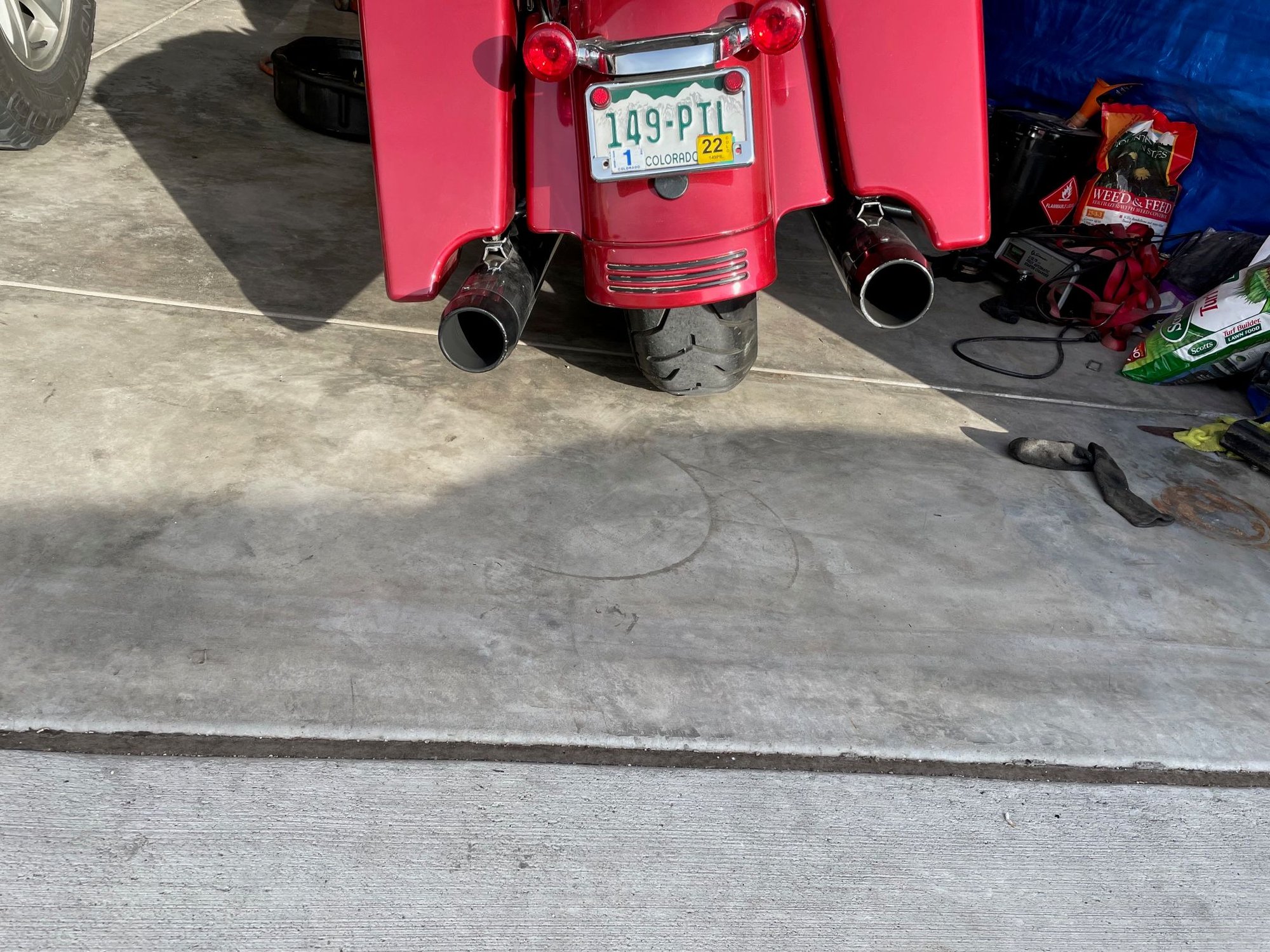

This is the rear of my 1999 Ultra
Toby
