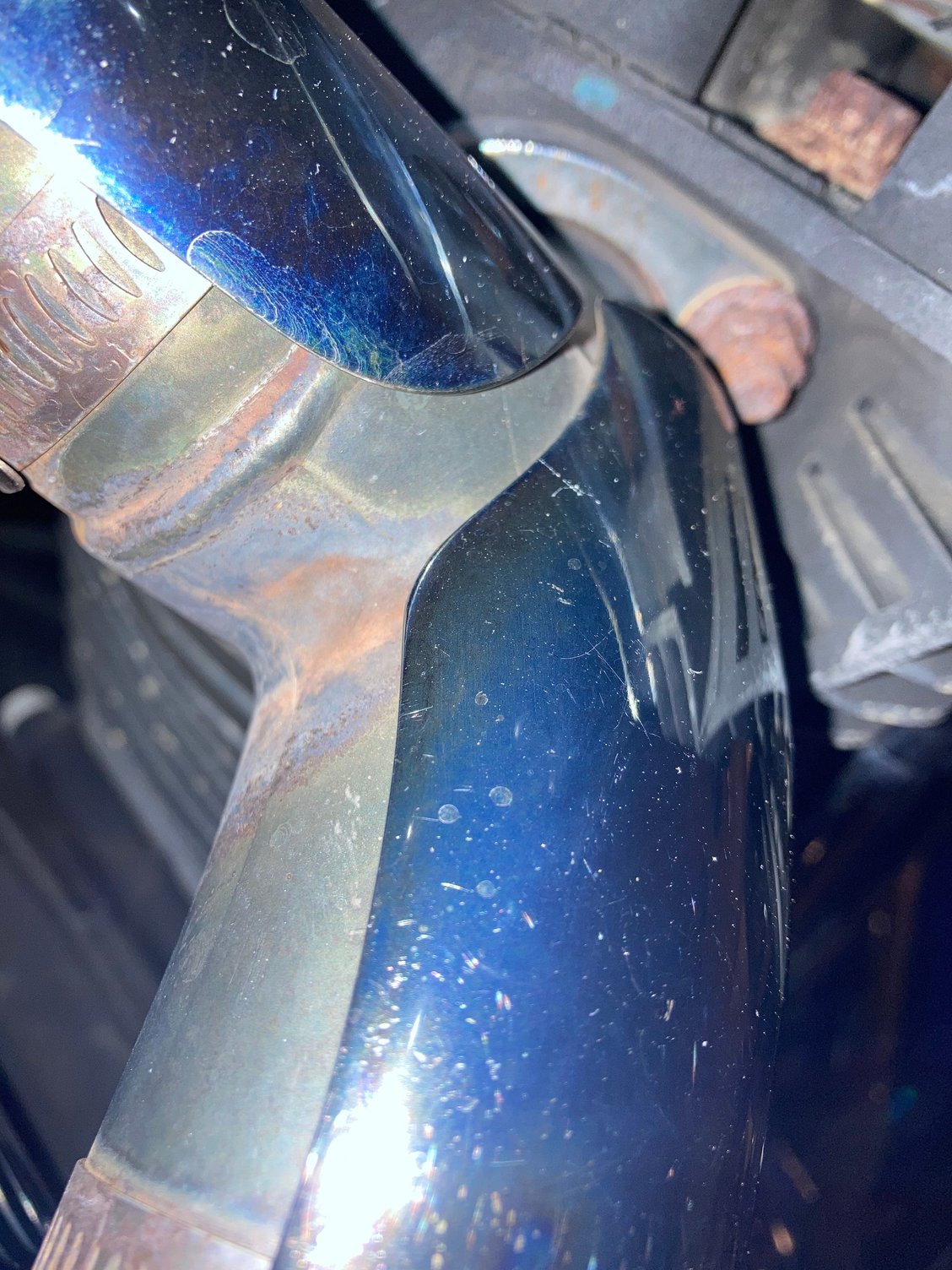

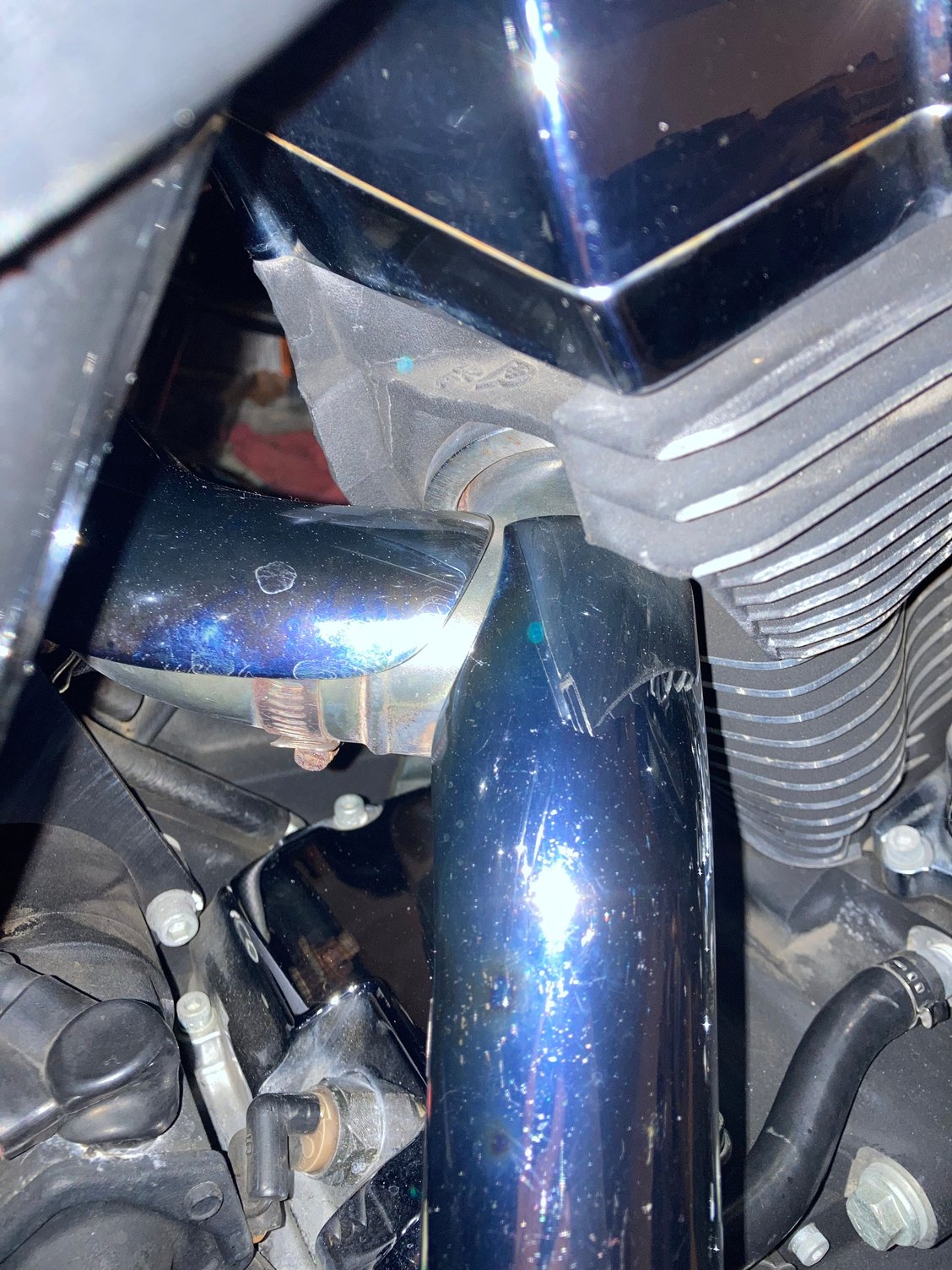

The more I think about it, I believe a previous owner put in new cams. This bike sounds incredible and runs like a raped ape. But, this exhaust looks stock and the air cleaner does not look like stage 2. I’m wondering if this bad combination of performance cams w/ stock exhaust/air cleaner is the root of my anguish.
This is a pic of my rear cylinder. Is this stock?

Looks like a stock exhaust , how about a pic of the air cleaner ? If it has an enclosed hard shell case , then I'm guessing it's stock as well , some stage 2 backing plates can accommodate the stock " football " , but will be open in the backside .

That is a stock exhaust header.

First thing is clean that IAC. It’s very easy to do and not all that involved. Next check for cracked hoses as mentioned. That exhaust looks stock - but it’s tough to tell really from the pictures.
