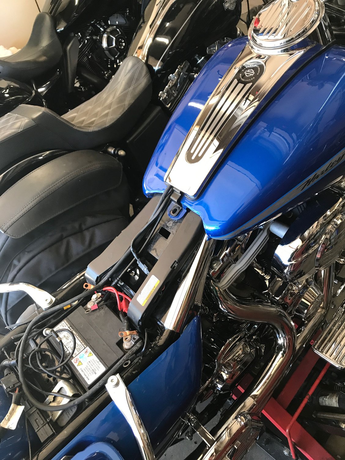

I know some older bikes had that gap on the short console, but this does not. Maybe a pic will help . . .
