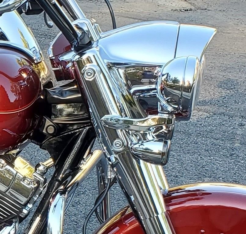

I used this kit on my 2010 to get rid of the towel bar while converting to bullet turns....would this work for you?

So I have the Road King standard aux lights on my 2017 RKS. Getting them together was a heck of a task. I referenced the SIP parts catalog and identified all the parts, ordered them on Surdyke and had them powder coated black. Lastly, had my indy mechanic sort out the wiring. Definitely a labor of love and more expensive than other aux light options but I really wanted that classic RK standard look. If you have questions send me a PM and Ill do my best to answer.
