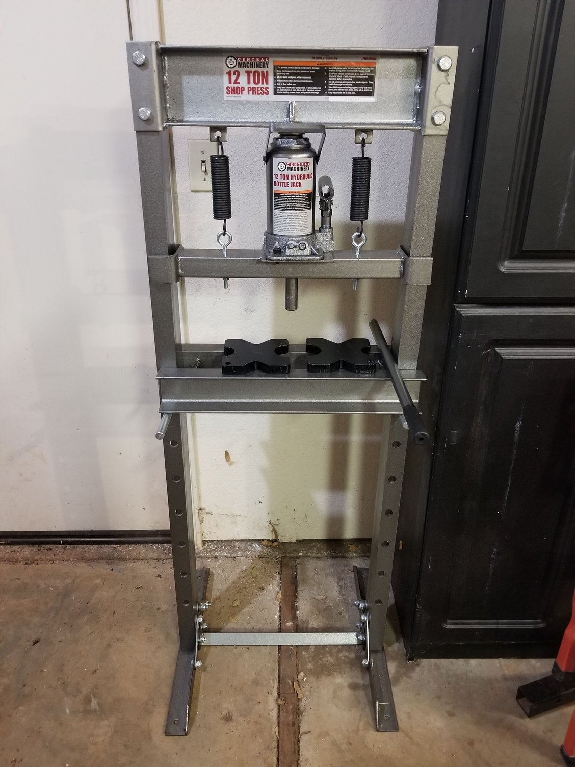

I got their 12 ton press for cheap. It was on sale and I had a 20% coupon. But when I got it home discovered the platten rods were missing. So the mgr gave me the ones off his floor model and another 20% for the inconvenience. My daughter worked near them so she picked them up. The cashier had a note from the mgr about the 20% off so he gave her another 20% off what the mgr already priced it at. He wasn't there and my daughter didn't know anything so I got 60% off! It's paid for itself many times over now. I pressed 7 bearings out and in on a GMC Transfer Case.
I use my Dremel for everything but yeah don't use anything like that on the filter. They make filter cutters but they're kinda pricey. One of these days! Here's my press.

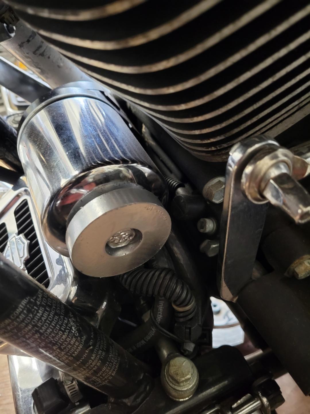

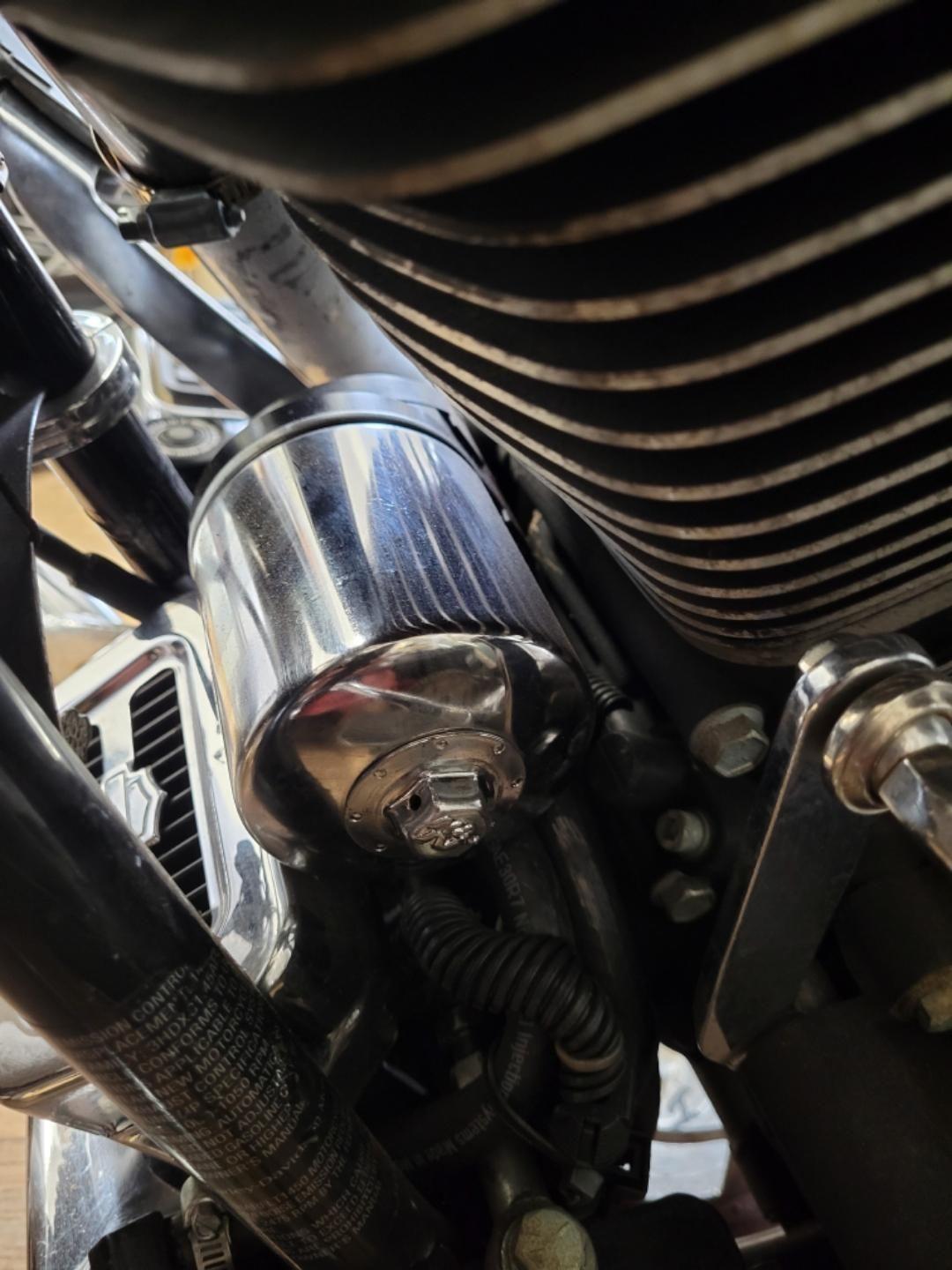

Here's a couple pic's of the magnets I scavenged from that old microwave. It's just a hair-brained scheme I came up with after seeing little chrome magnets about the size of my thumb nail,
4 being placed around the filter mid way, being sold through a very reputable M/C Parts MFG. Won't know how well this will work until I get the new parts in and change the oil. I will open the filter and send along pics then as well.
