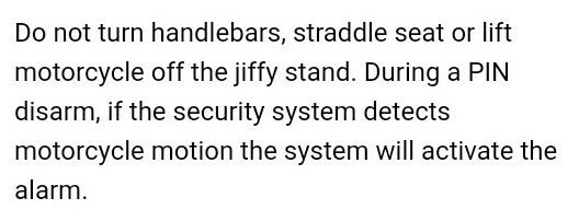

When attempting a PIN disarm, it is important that the bike remain motionless during the entire procedure. The system remains armed until the PIN disarm is completed in it's entirety.
If the alarm is activated prior to completing the PIN disarm procedure, it will be necessary to start all over from the beginning.
that may explain it! I will try it again this afternoon. I was sitting on the bike just after unlocking the bars and standing it up
