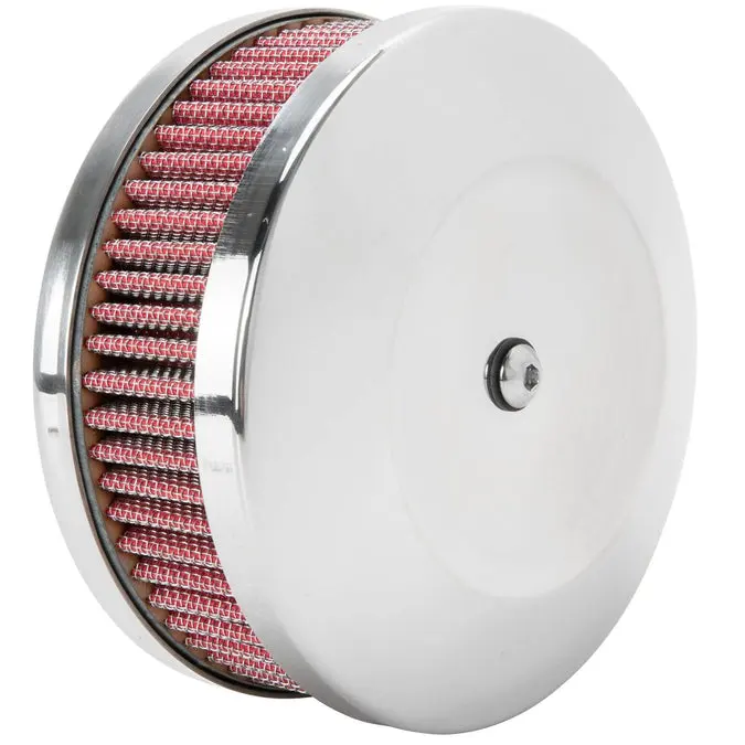

Originally Posted by Rogerio
I have a 2006 Road King classic . It is all stock but wanted to get this high flow air filter from Amazon. I didn't think i needed a tune considering it was stock. I do want to put slip ons later on. Someone told me it needs to be set up for high flow filter. Is this correct?. https://www.amazon.ca/Motorcycle-Tur...d_i=B084N8X6HK
Kind of a weird looking filter for a classy Road King? I went with this one from Lowbrow Customs last year on my Dyna, made in the USA by The Gasbox in Ohio for $99.95. Install was simple & it's made out of stainless steel instead of chinesium. I bought breather bolts from TC Bros for ease of install. I did need a bracket but you might not (it's steel & connects to the heads at the breather bolts) but it'll still be about the same price if you have to buy the bracket & breather bolts. Here's the link-
Gasbox 007 Stainless Air Cleaner for Harley-Davidson CV / EFI 1991-2019 – Lowbrow Customs
Pics-
