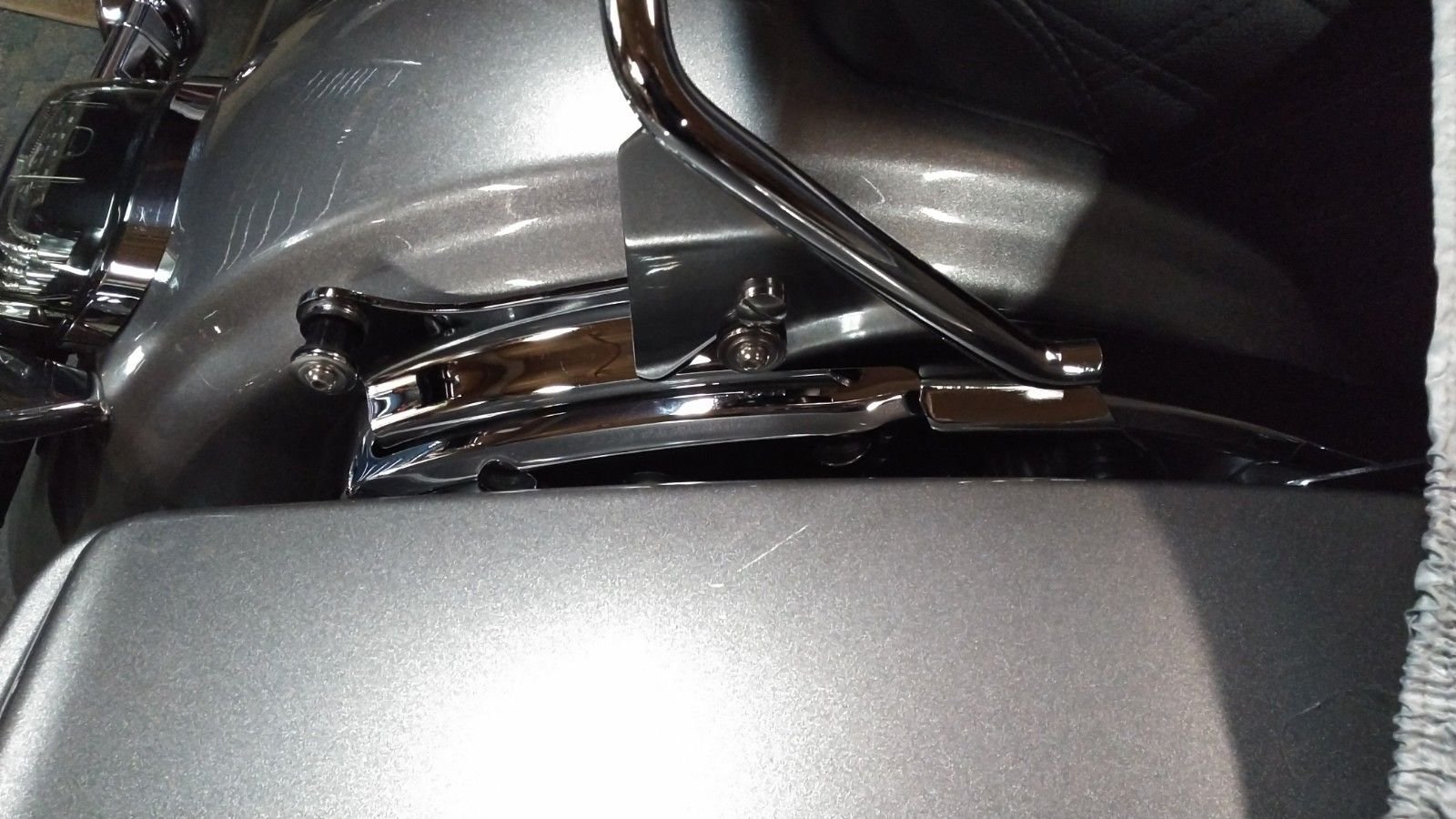

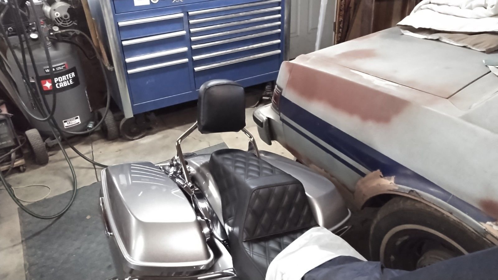

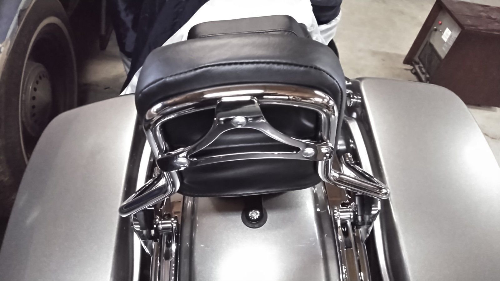

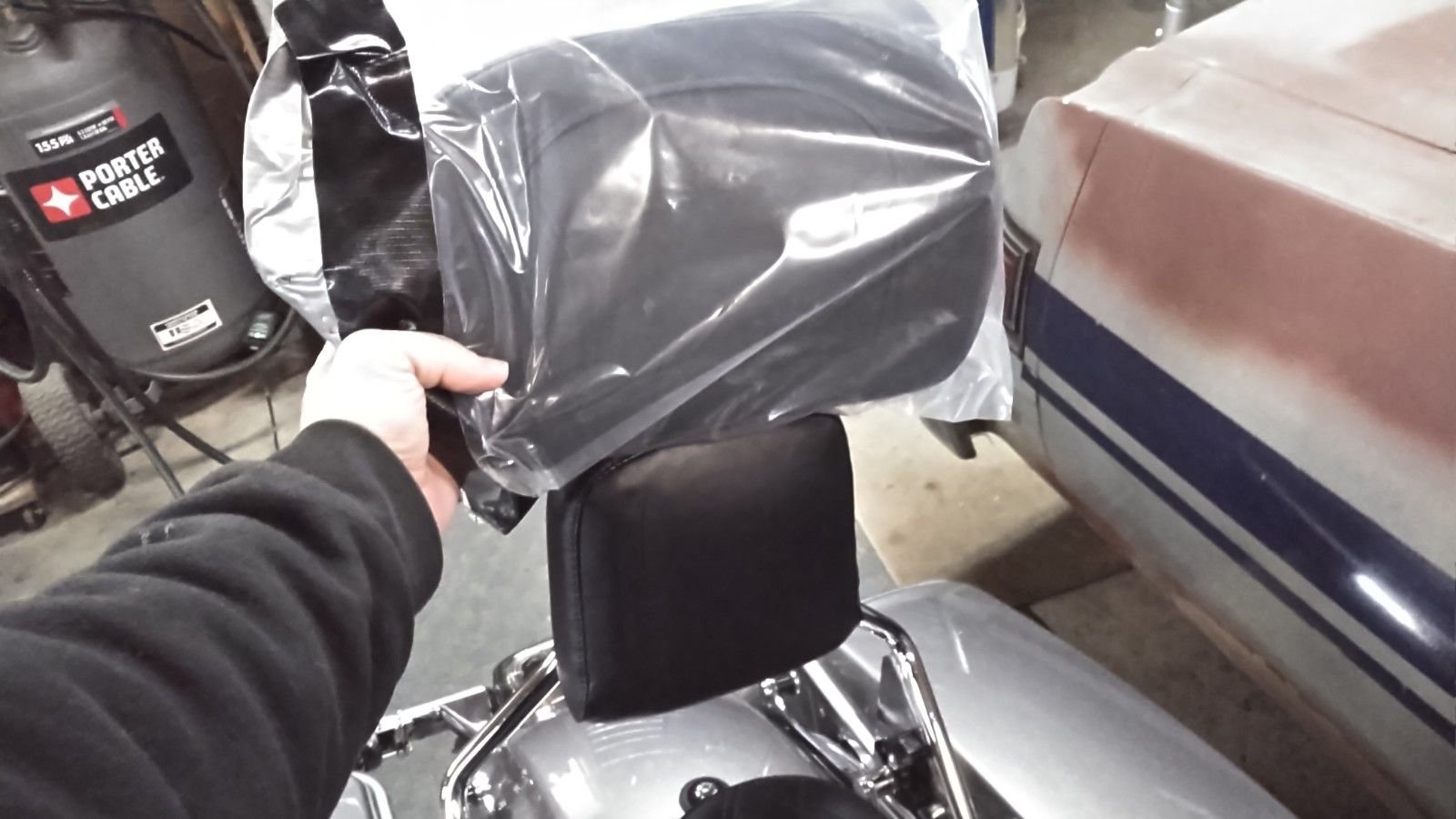

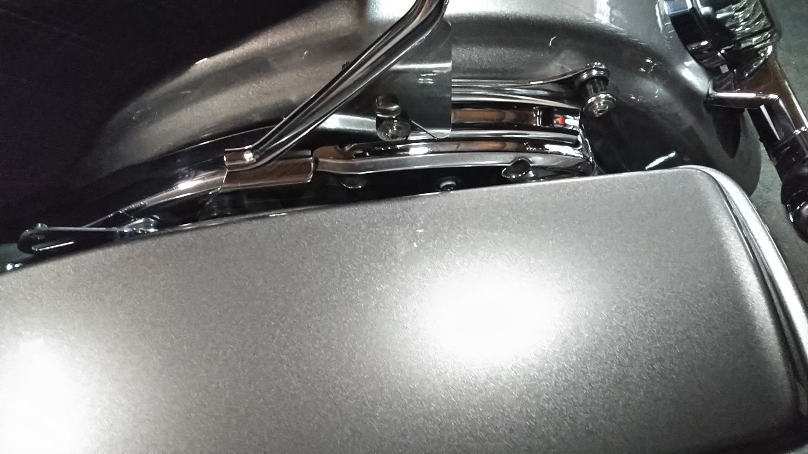

Concerning ebay/amazon chinesium stuff- Last year when I bought my Road King my Dad came to look at it & said it had everything but a sissy bar (he really likes the old school looking stuff). For Christmas he bought me a sissy bar kit from amazon. I decided that it didn't look too bad aside from the backpad (it's huge) & installed it.
The good- All the parts were there. It's definitely sturdy & once I had it installed, it's not coming off.
The bad- Nothing quite fits "right", it took a lot of finagling & I even had to use my vice to spread the bar to get it to fit on the mounts. Still, I had to loosen all the bolts on the mounts to install the sissy bar then re-tighten them. Now, to remove the sissy bar I'd have remove the bags & loosen the mounts. Luckily, I'm okay with leaving it on.
This whole experience is completely different than my Uncle's when he put a genuine HD sissy bar kit on his Street Glide- it fit & worked perfectly.
As far as the backpad, I went to the local HD dealer (Valley HD in WV) & bought an HD backpad for $75. I even had to modify the stock HD backpad mount as it's totally flat. Any pressure from above on the backpad would cause it to slide. Into the vice it went with soft rubber to protect it & a little sweat/cussing later, I had the top curved enough were it won't move. I guess what I'm saying is that nothing seems to be perfect anymore, but you still seem to get a better product when you spend a little more money. Pics-

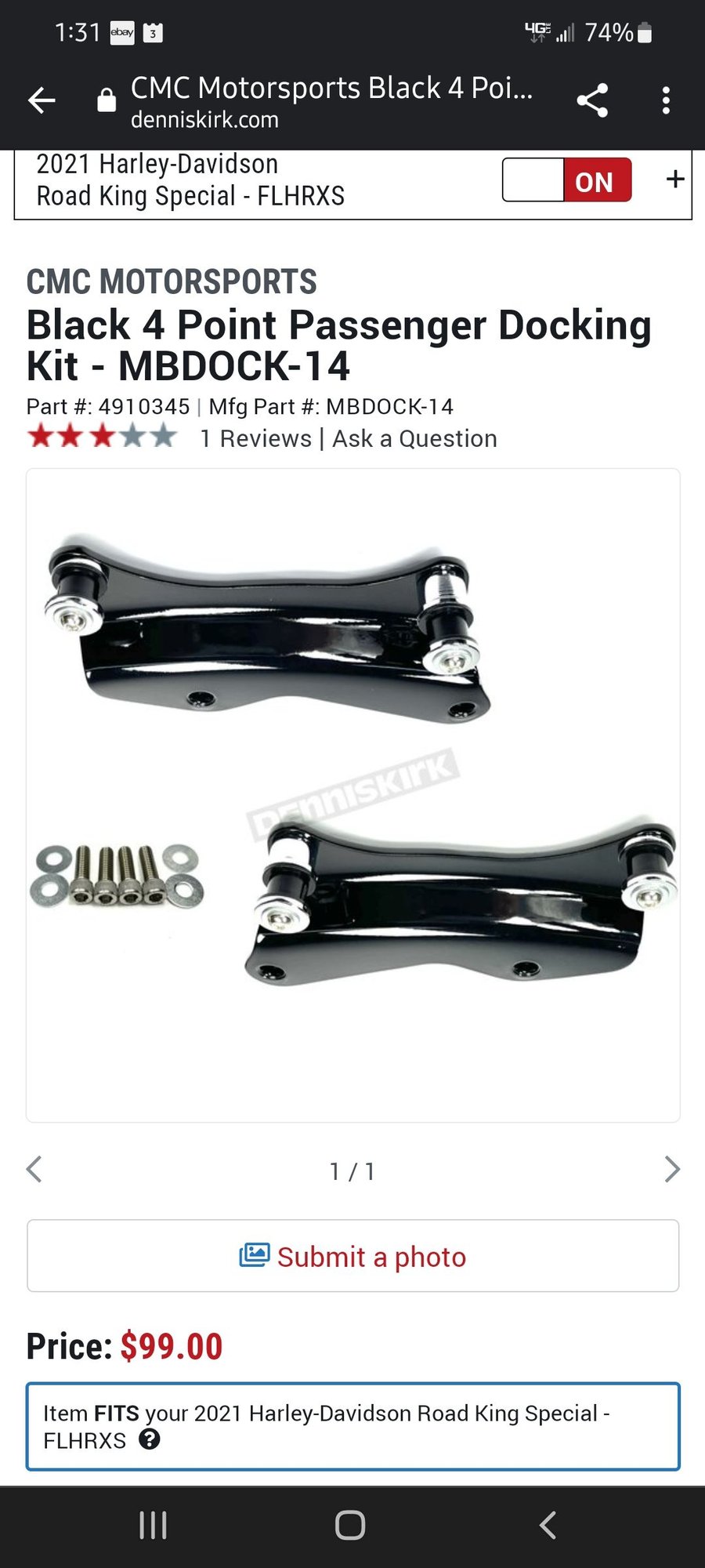

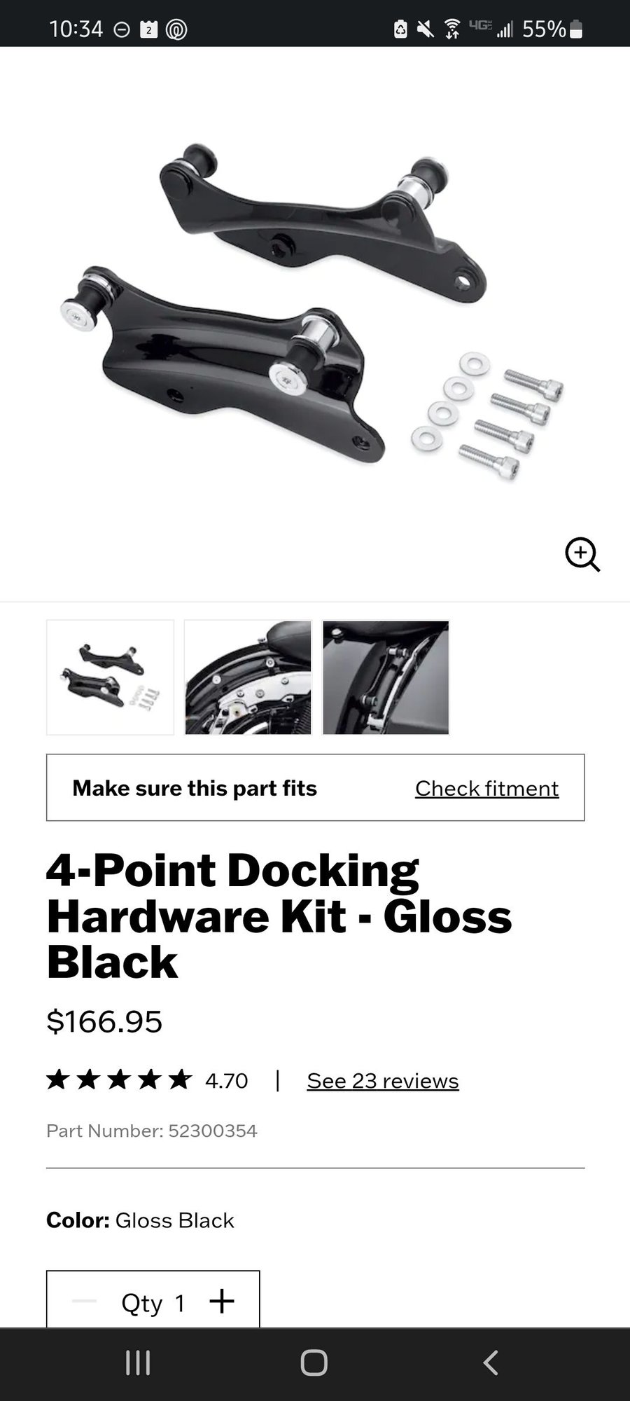

First phot is a hogworkz, second is a knock off brand sold by Dennis Kirk. Basically I'm around $150ish for harley brand and hogworkz OR $100 for a knock off brand....harley does give you 1year warranty AND points if I use my harley card at the dealer?
Then buy a knock off sissy bar like mentioned above which I was looking at anyways
