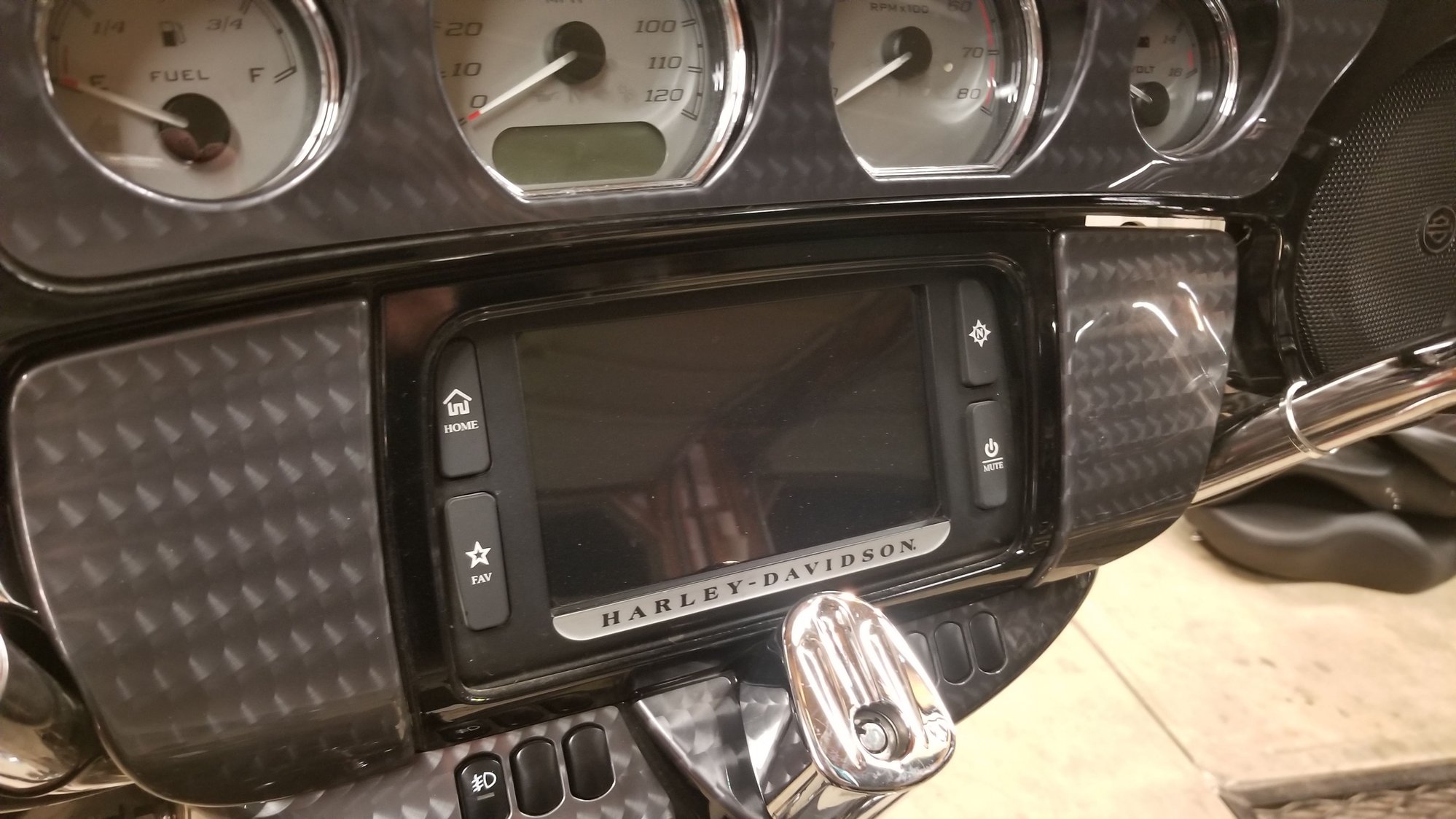

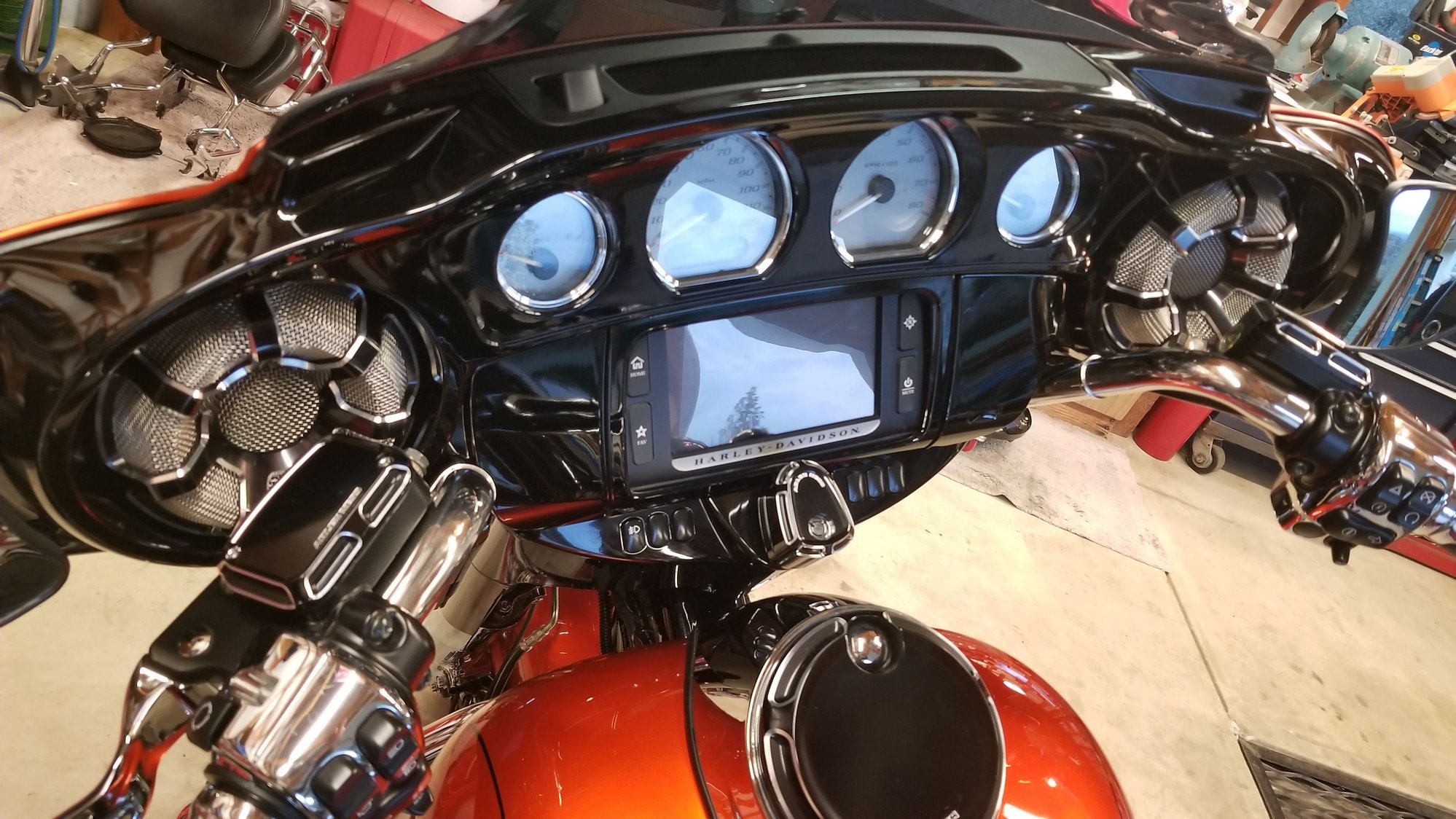

I have used WD-40 for adhesive removal on various things with good results. Used it to get rid of the residual adhesive left when I removed the HD stick-on tin foil like fake Carbon Fiber looking covers that the PO had someone put on the inner fairing on my 14SG. Took some work, but no evidence of damage on the gloss black finish at all.
I agree, the fake carbon fiber thingies looked way better in the bottom of a garbage can than on your inner fairing.
