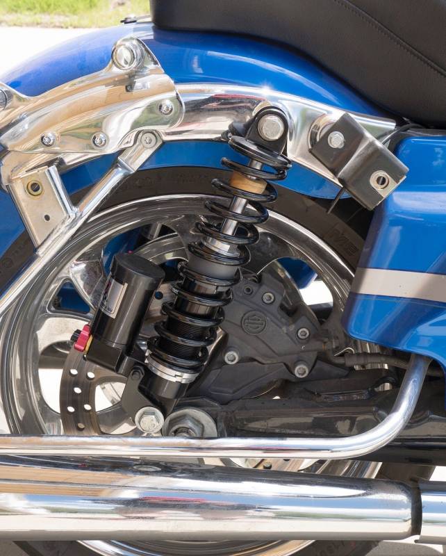

I've had the RWD RS-1 standard spring shocks since May or so, and are on a 2022 RG 107. My wife and I's combined weight is right around 350.
When I first got them, the springs were tight and I ran the black dial at setting 5. Somewhere in there I had experimented with the red clicker and had added 1 click just to see. Very harsh and removed the 1 click. As the shocks broke in, I added more preload to get to 0.5." of preload when sitting on the bike from a laden stance. I had then dialed the shocks down to 3 clicks. However, I had done a run from Bergen County, NJ to Great Barrington, MA a month or so ago with my buddy. A good portion of the trip was on the Taconic Highway in NY. The road has a lot of bumps that give a jolt. Over the course of that trip, I wound up dialing up the clicks again to 5. However, while it helped with the bumps of the Taconic, for other road imperfections, the shocks felt jolty. Once home, I had dialed them down to 2 clicks, and while not perfect, they were a lot better.
My wife joined me on my bike for a trip to Bennington, VT for lunch. On the trip, I was changing settings here and there and had settled on 6 clicks, and this seemed to work pretty well. That trip inspired a new seat (Mustang SuperTour Deluxe) since my wife was not too happy with the stock RG seat. The next time I rode the bike, I forgot to dial back the clicker and had left it at 6. I was really surprised to find it was the best setting yet. Shocks absorbed just about everything short of a crater pot hole really well (which would challenge any shock). On my next outing, I'm going to experiment with 7 clicks just to see. I have a feeling, it's going to tick up the plushness. At that point, I want to again futz with the red clicker...just to see. I do wonder though if I should have gone with the HD springs. I'd guess then, dialing up to 9 or 10 would be ideal for my wife and I.
I checked, my shocks have 14 clicks on the black adjuster (haven't checked the red). On my last bike (2013 Dyna Switchback), I had installed 13" Hagon Nitro's. It literally took me about 4 seasons to really get them dialed in. Happily, the RWD's are coming along quicker, and they are proving to be better than the Hagon's. Very happy with these. At one point I was 2nd guessing myself and wondering if I should have gone with the Ohlins HD044's, but no more.
Also, I installed the Traxxion AR-25 fork kit (the kit comes with their damper rod with their version of the Gold Valve Emulators in the top of the damper rod, their straight rate springs and 2 containers of oil for $499). I don't know, but I'd wager it's very similar to the ProAction fork kit. It has broken in now and has proven to be a very nice upgrade for the front. The fork kit and the shocks really have transformed the experience of the ride
